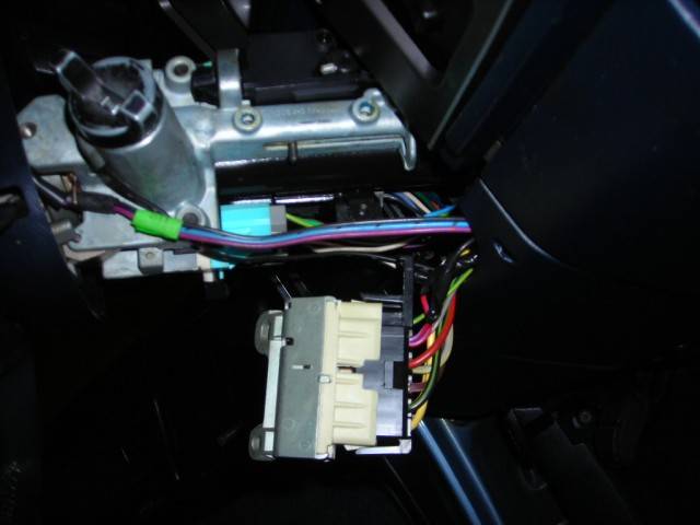

I replaced mine as a maintenance item just because they're so cheap. If you have security torx bits then it's simple to replace.

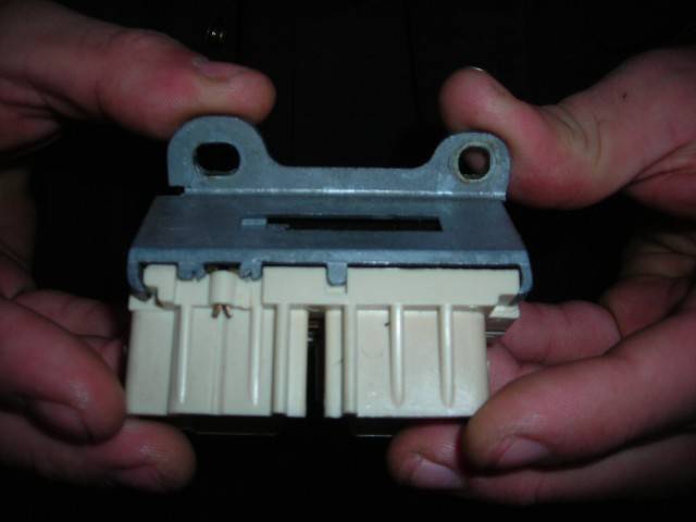

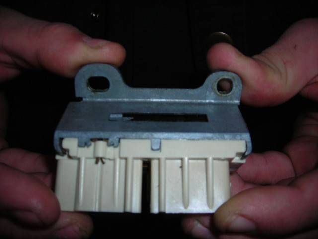

I've written dozens of pages of stuff on this but, I really think that a picture is work a thousand words. Check out this ignition switch from my 1988 ... with only 24,000 miles on it .
This is how they're SUPPOSED to look.

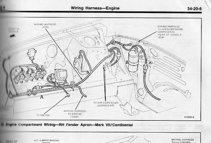

Found and Repaired Constant Cranking Starter
First off thank you all for the ideas and help, w/pics even.
I had only pulled out two of the in dash relays, when I started tracing the wires from ignition switch out through the fire wall into engine compartment and found the source of the problem. The Electrical connection underneath my Radiator Overflow Tank, just forward of where my Coil is mounted on the RH Fender Apron. The Following 2 links show the wiring layout at source of problem.
http://www.lincolnvscadillac.com/attachment.php?attachmentid=40009&stc=1&d=1232221680
http://www.lincolnvscadillac.com/attachment.php?attachmentid=40010&stc=1&d=1232221680
The Overflow Tank was leaking out a pin hole in the bottom onto the Connection labeled "A" in each picture link above, causing it to arc together, melting the Connection into a brittle lump of plastic with 8-10 wires all fused together. Spent 4-5 hours cutting the wires back and then soldering them each back up into a continuous electrical line (no more male-female plug in) and fired it up, no more problems with the starter. Put the relays and the steering column shroud back into place and all is well with my 1984 Lincoln Mk VII LSC. I am amazed that was where the problem ended up as I had become positive that it was up under the dash.
