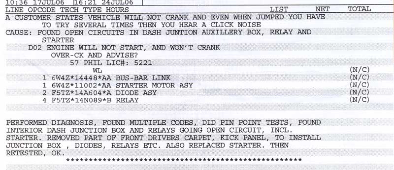

well I brought my car in for the 4th time for the same problem. 2 days now and no problems. They have changed just about every part in the starting system except for the alternator, so i hope that is fixed now. they even called the ford engineer for help on this one.
problem: car will not start sometimes(even with jump)
1st visit to dealership: replaced battery
problem comes back 3 months later
2nd visit to dealership: replace ignition switch
problem comes back a couple weeks later
3rd visit to dealership: replaced battery
4th visit to dealership: see below attachment
Damm I hope the car is fixed this time!

Yes I did. It ended up being a loose wire at the junction box behind the front inside passenger wheel cover(the black cover). They tighten the loose wire and I haven't had a problem yet and it's been since May I believe. They followed every wire from the trunk up to the front(I could tell, nothing was put back right) and they found the wire finger loose. Every once in a while when I tried to crank the car I could hear a short down by the tire which lead me to believe it was the starter but that was not the case.
Hope this helps and report what they find.
