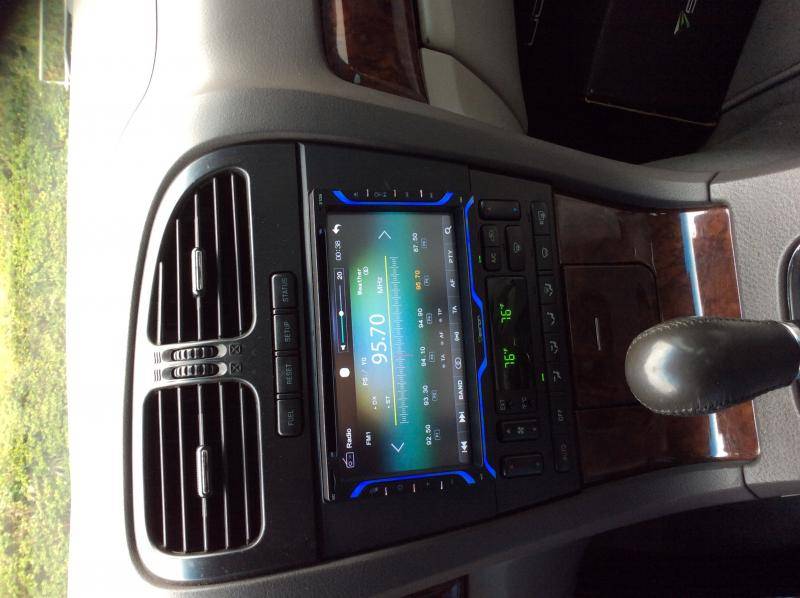

Soul...is that an aftermarket dash trim piece? Metra, perhaps? How well does the color match the rest of the "silver" trim pieces? Or, is that your factory DIN one? Thx!
It's a Metra kit recommended by Joegr. Looks amazing, literally a perfect OEM look replacement.
one thing I alway recommend with the LS dash kit, is for a little better look, you can trim between 1/8th-1/4 of the back side of the radio opening out, the radio can be slid further out making it more flush with the dash kit itself, instead of sitting so far back in that hole. I really don't understand why metra made the kit like that...
