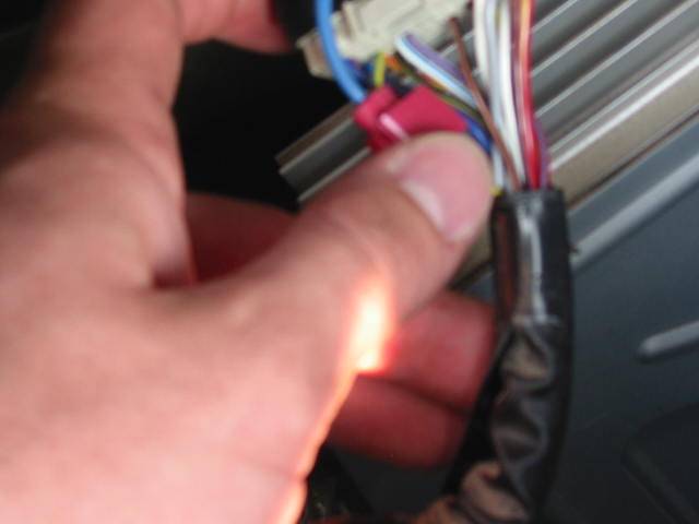

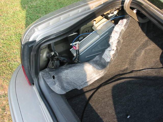

Jaysal555 below are some pics of what I used for the remote wire. The wire is actually yellow with a bluish green strip. My remote wire is the blue wire.
hey rebel is that the sub amp or the amp for the other speakers? I thought the sub amp was on rear deck...could be wrong. problem if you tap on regular amp is I think the HU cuts low frequencies to that amp as volume increases to avoid speaker damage. not a good line to tap if you are wiring subs. Could be wrong.....
