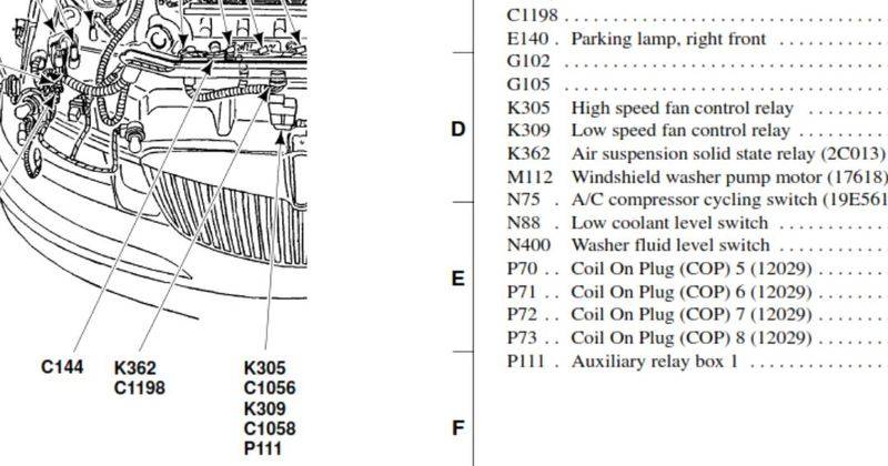

Is the relay directly behind the grill, but in front of/before the A/C condenser?
Or is it in the actual engine compartment, mounted above the radiator shroud, like under the lip of the upper radiator crossover support that slightly hides the shroud when looking down at fan area?
