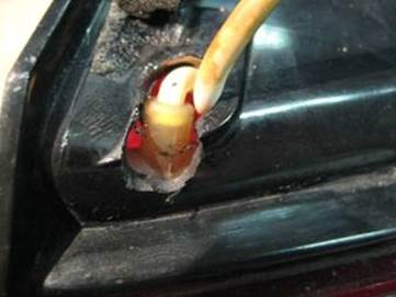

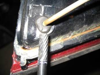

13. Think about doing the following steps before replacing another inverter.
Without cutting the housing open; the attached are steps that I am developing in preventing arching from the input (GTO) wires.
Pull the rubber gourmet out
use a ¼ inch cutter; trim into the housing
Pull the excess of the GTO wire out
Put small amount of silicon calking in and around boot
Glue the hole closed
Tape over area to act like a water shield
Using electrical tape; tape a 4X12 inch section of the trunk lid in the area were the GTO wires pass thru the light housing. (from the edges, inward)
Use two additional (6 to 8 inch) sections of GTO Sleeve; cut an 1/4 inch wide 1/2 inch deep notches in one end.
With the notched end first; slide the sleeve over the section of GTO wire that enters the housing. Make sure the GTO sleeve overlaps the rubber grommet area.
Now you’re ready to replace the inverter
