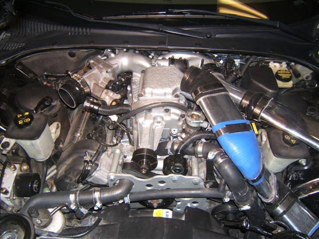

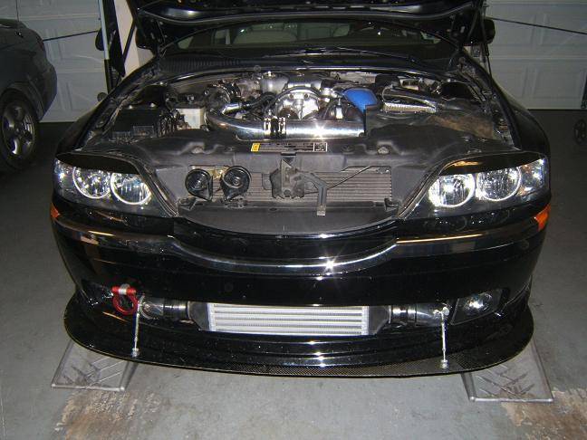

here's the latest....

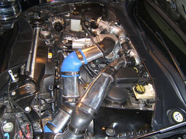

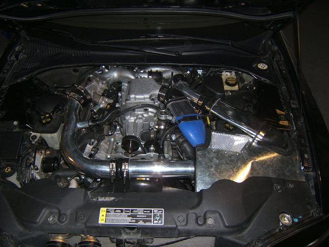

I finished the Cold Air Box - matching it to the hood scoop....
and then trimmed and fitted the bumper.... and re-installed it
started up - yep - the tubing on the SC side is hot - after the inter-cooler is cold....
I haven't hit the streets yet....
I just peed my pants out of intimidation. :D Get that baby on the road and let us know how she goes! Nice, nice work quik...

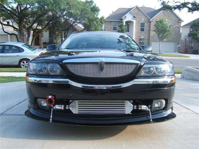

Quick, This may have already been asked, but what is the red loop on the front of your bumper?
I don't remember seeing that in previous pics.
it's how the car gets home after I blow my head gasket... ;)
the car is so low, even lower now with some of the intercooler piping, that tow hook may be the only way to trailer it if it needs to be...

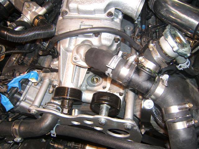

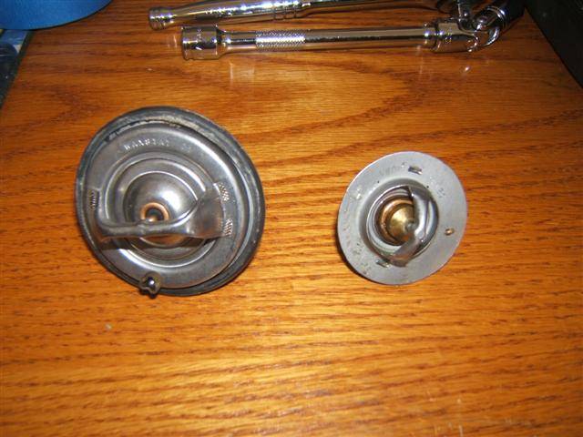

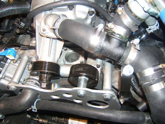

Update - no more cooling issues! (well so far)...
found the culprit - thermostat
had to move the SC to get at it....
you can see the stock LS thermostat is on the left - much larger than the replacement we used...
