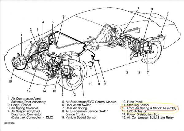

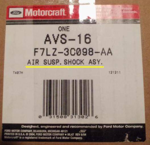

Ford knows what they are:
Also:
From a Ford service manual. I've personally never seen any literature from Ford that calls them "struts". I think the engineers at Ford know the difference between a strut suspension and an SLA suspension. But I could be wrong. One never knows...
