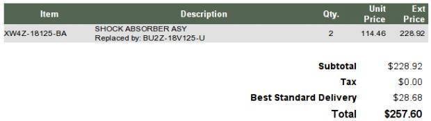

FordPartsGiant Customer Service said:
Your order requires an additional charge due to the following reason(s):
Hello
Thank you for ordering your parts with us.
Unfortunately part #XW4Z-18125-BA Replaced by: BU2Z-18V125-U has been discontinued by Ford. Due to this part being discontinued there are only a few sources that show to have this part available.
In order to obtain the part from one of these sources the price of the part has a higher cost. The new cost is $278.92 for both parts which is $50.00 more than the original cost of $228.92.
If you choose to accept this cost the order cannot be cancelled or returned at any point. The part(s) will also take us 3 to 5 days to receive before we can ship out the order.
Please indicate on how you would like to proceed with this order.
Regards,
Customer Service Dept.
hey, at least they can still get the part somehow...
Yes, and that is what I ultimately concluded. After some additional extensive searching, I decided that part simply isn't available from anyone else.

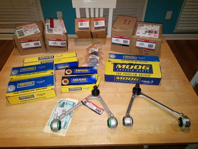

The first wave has arrived.
I was very pleased to discover that the Moog components all included the new hardware too. Nice!
Also, as a point of interest, you can see that for the front upper control arms I got one Moog and one Motorcraft. As has been well documented, the Motorcraft part has "Jaguar" cast into the arm. Beyond that, it seems that the Moog part weighs about 5 oz more than the Motorcraft, which makes the Moog roughly 16% heavier than the Motorcraft. For whatever that's worth...
^ again, what is it with these suppliers that can't seem to send two matched L/R control arms from same manufacturer. It's like it's all turned into a "will have to do" world. As long as they get their money.
PS: polish that right one or both up to shinny chrome look. Nice!
Actually, that was my fault. I ordered one Moog and the other Motorcraft because the Moogs were out of stock on that side.
How was the build quality of that Moog upper control arm? You ordered the "R" version which is their budget version designed to compete with Mevotech and DP. All I keep asking myself is how can they shave $20-30 off a part which just has bushings and a ball joint. It's always driven me away a little because of it.
