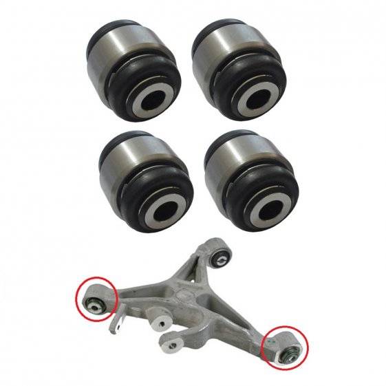

What about the rear lower control arm's ? High $ item and the cause of squeaking on my 2000 non-sport.
I am considering replacing the bushings and was about to post a thread very similar to yours but just may piggy back for now and see what happens.
Duetchparts items i am considering.....
2000 Lincoln LS Base 3.9L rear lower control arms
I know a few people are looking at doing these, but am waiting to hear some feedback.

PRESS EM OUT , ARBOR PRESS CAN , AUTO MACHINE SHOP ABSOLUTELY COULD. tHEY WERE PRESSED IN, THEY CAN BE PRESSED OUT. mUCH LESS$
Only problem with all of this... is that Ford doesn't sell the bushings separately. That means new control arm... unless they can be sourced individually from Jaguar.
Moog has a couple bushings for the rear lower arms... that's it. The bushings are a bear to get out regarless of availability.
A few members on here have done it with a large steel cup... heavy duty bolt and washers... and drew the bushing out of the arm and into the cup. Same method to draw the new bushing into the arm. Urethane bushings are available through aftermarket, (Power Flex is one), but urethane bushings come with their own caveats.
Labor intensive no matter how you look at it... so not cheap to pay a shop to do.

There are no bearings in the control arms. Very different from a snow blower axle.
The outer sleeve of the bushing is larger in diameter than the hole in the control arm. ("interference fit") to keep them from coming out (walking).
Arbor press won't have enough pressure to install the bushings.
Now if you mean shop press... then possible but still tricky.
Again... there are a few threads on here where members swapped bushings manually with a home designed tool.
Ball joint removal tool may work also... with the proper cups.
