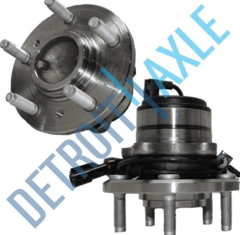

Hey guys. This week, after a long journey from Atlanta to Orlando, I started to find that the my LS 04 has a a loud noise coming from the front part of my car. It is louder when the speed is over 50 miles. And I can feel abnormal vibration on the throttle pedal.
At first I thought it was the engine problem and did worried a lot about it. But today I took it to a mechanist, and he told me that it probably from the worn out wheel bearing, though he can't tell which side is it. He pushed the engine speed to 3000 rpm and no such noise and vibration.
I searched the wheel bearing hub assembly on eBay. They are relatively cheap, 2 for under $100. I can imaging the process of replacing it. Remove the wheel, the brake pad and caliper. Then loosen the bolts that secure the hub. But in my experience, the hub assembly were usually extremely tight, as the metal parts contact is rusty.
I saw some videos on youtube about using a puller but most of them require turning a bolt against the axial which doesn't exist in this case since this is front wheel hub. The hub is solid in the center, no through hole. So in this case, what kind of tools should I use to get the hub out, if it's really rusty?

I wasn't sure about which side either. I guessed that it was the right side (60/40 chance). When I took the caliper and disc off, it was very clear by the feel of turning the hub that it was that side. It felt kind of crunchy. You couldn't tell with the wheel and brakes on, but it was easy to tell with them off.

Just a loud droning noise above some minimum speed. There was no shake or vibration that I could tell. You couldn't hear it outside the car as it passed by, but it was very annoying inside the car. I thought it was coming from the back, but fortunately it was the front.
I replaced my left front a month ago or so. Same thing, drone at upper speeds. Being a NJ vehicle I was expecting the story of a corrosion between the hub and aluminum knuckle doing an issue after 15 years, but the hub dropped right out.

I remove the driver side front wheel bearing hub this afternoon. Took about 1 hour to diagnose and 1 hour to replace. As you said, fall out very easily. Though I should replace both side, Autozone only had one in stock. However, the feeling of my car now is smooth as milk.

For the record, mine fell out when I took the four bolts out. Anyway, here's a way to do it if it is stuck...

^This is exactly what you’re NOT supposed to do (in case someone reads through these posts for help). The service manual specifically states to not hit the bearing with a hammer or else you can damage the knuckle which would be a costly and time consuming mistake.
Follow the link Joegr posted to the DIY bolt pushing method if it won’t come out.
