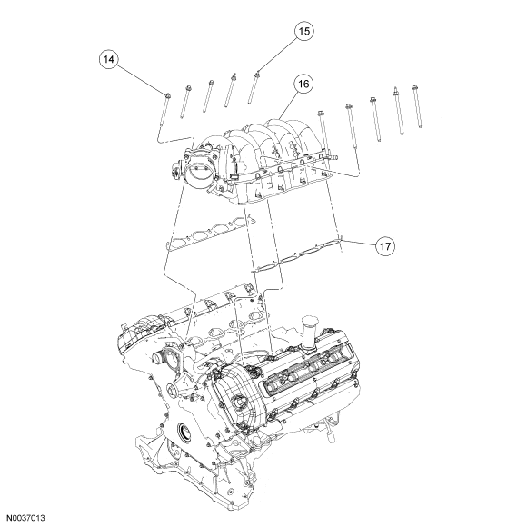

To take off the manifold do I only need to take of the ten bolts shown on here or is there more I need to do once I take this part off? engine screw.gif
There are a couple of nuts at the back that face rearward that hold the wiring harness on. Those at least have to be loosened to get the harness off. There's also a vacuum hose to pull off. There's also a sequence to use to re-install. This covers it fairly well.

Hey thanks again. DO I need to do all the steps shown such as disconnect 8 fuel injectors and the radio interference, Remove the 2 nuts and the engine wiring harness retainer, Remove the nut and the radio interference ignition capacitor, Disconnect the fuel supply tube spring lock coupling from the fuel rail, Disconnect the fuel supply tube spring lock coupling from the fuel rail? I just ask because I have no idea what these are, what they look like and where to find them.
Yes, those things have to be done. Be very careful with the fuel injector connectors. The plastic tabs that locks them in are very brittle and easy to break.
