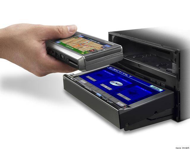

First of all the W200 already has a successor; the W205 pictured here.
Crutchfield has some good info on it.
The W200 does not lower it's face all the way down like the W205 does and the DVD slot is at the top not the bottom. The Alpine portable navigation looks promising. The unit fits the dash very nicely. I did not install mine personaly so I can't say how hard it was to trim that face plate to fit. I did have to remove the unit in order to get the steering controls to work (my shop could not get the PAC unit to work although all I did was follow the instructions).

I would say there are two things I dislike about the W200: Limited audio adjustment and it takes a while to eject a disc (5-10 sec.). This is the first double din unit I have owned so moving that screen out of the way could take some time. Check out this item on the W205 if you purchase that one since the face opens farther. This might not affect the eject time but could interfere with your shifter (I believe the radio is above it but it is better to be sure).
Alpine's hardwired navigation is expensive. No word on the cost for their portable unit compatible with the W205 though. Looks very promising to me if you want to have navigation. I would guess the price to be comprable to a Garmin.
