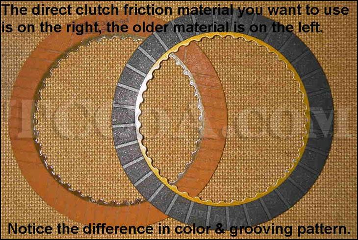

It's true that the pre- 98's are fine for normal power levels but there were some good things added to the 98's that would likely keep you worry free of shudder and allow you to do manual 1-2, 2-3, 4-2 shifts, like the intermediate one way clutch and also, in 98, the friction material was swapped over to a better, longer lasting material.

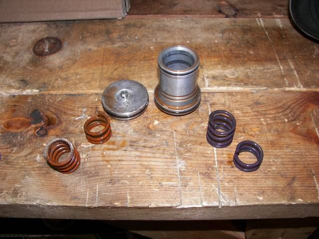

This is what the 1-2 looked like in my Blue 93 when I did the JMOD:
how many miles?

That was right about 114k. We've put another 50k on it since it was JMOD'ed.
