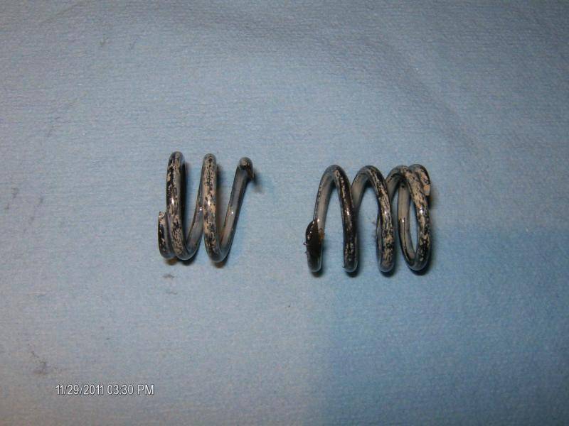

If you plan on getting a chip for the car, then put the springs in. If you plan on leaving it stock, leave out the 2-3 spring. There's only one spring on the 2-3 accumulator. None of my cars have a chip, and I've left the 2-3 spring out on all of them. The 2-3 shift is perfect without the spring.
I've left both springs in for the 1-2 accumulator on all my cars. My 93 will still bark the tires from 1-2 if I get into it from a standing start.

FWIW, the '98 transmissions break the lower 1-2 spring also. The last two '98's that I've done (including my car) both had broken lower springs.
