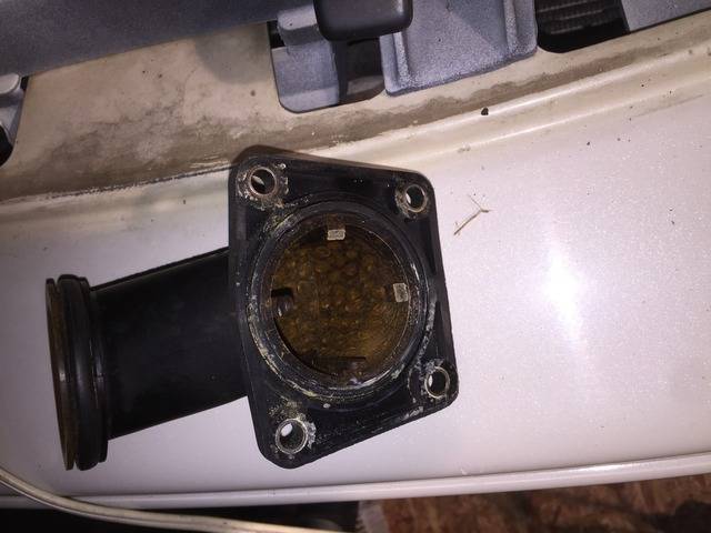

My thermostat housing blew an end cap off.
I thought my stuff looked newer, like it had been replaced within a reasonable time. My degas bottle was yellowing, but didn't look that yellow.

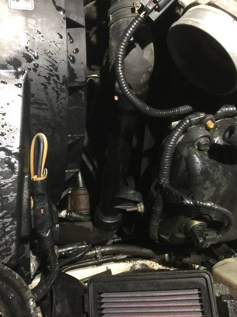

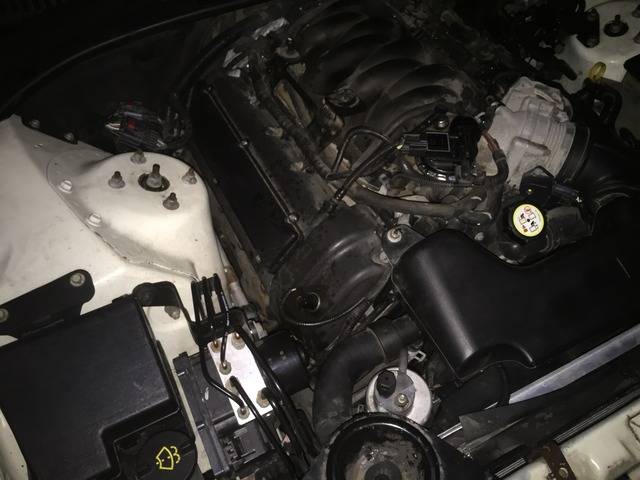

Here was my engine when I was on the side of the highway at 4am. Doesn't look like much, but the drivers side of the engine was drenched in coolant. Fan, radiator, hoses, top of the engine, etc.
Pass side was pretty dry
Then I finally saw THIS
This is on the drivers side. This hole normally has a cap of some sort glued in place. (Not a cap that you remove, like a radiator cap)

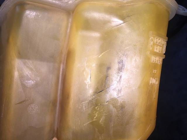

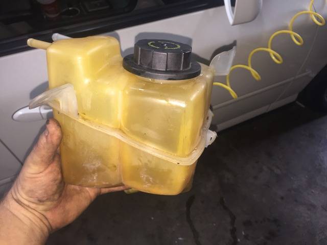

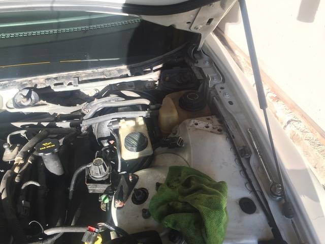

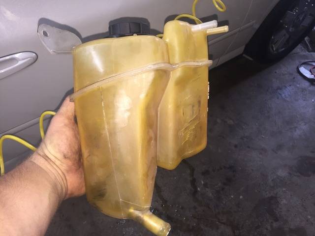

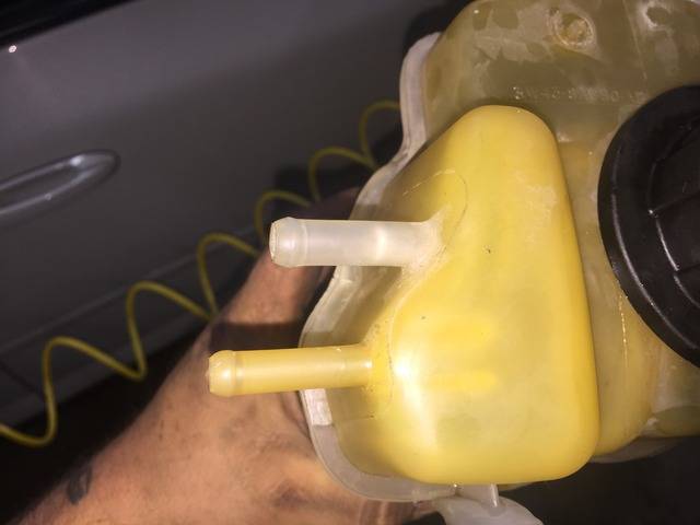

Now with the wiper cowl, and strut brace removed, it was much more evident that my degas bottle was baaaaad.
Ive always read that the degas bottle develops cracks in the back, that you wont see unless you remove it. Nah, not mine. Its not leaking.
Wrong.
Front
Check out that color difference...
Said cracks

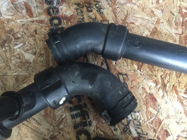

Here are the common failure points. Any plastic you see in this pic will need to be replaced sooner or later.

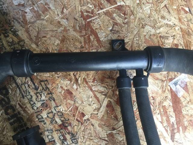

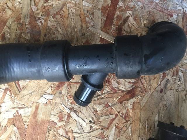

Lower rad hose (If you have the oil cooler, it has the two smaller hoses coming off)
Upper

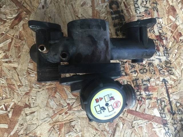

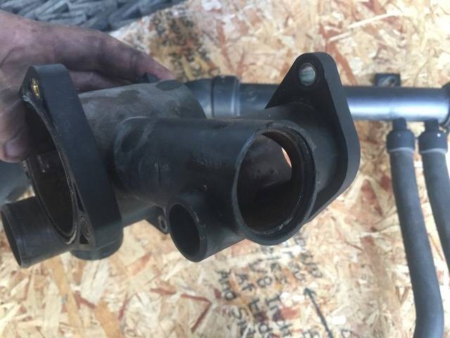

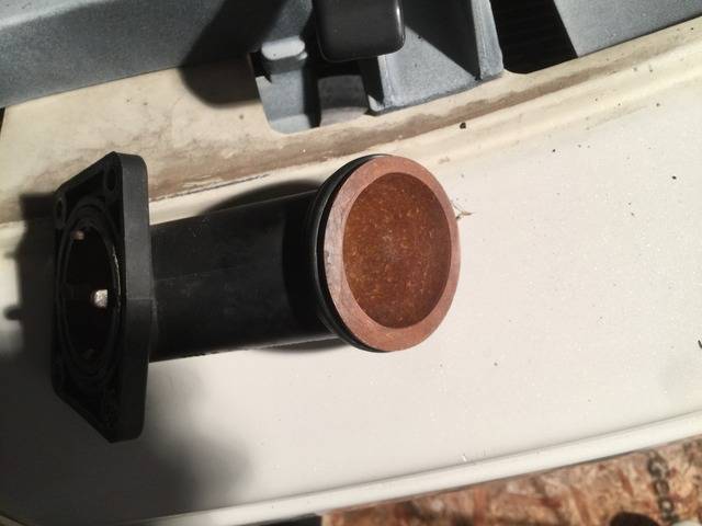

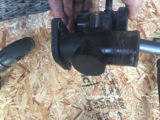

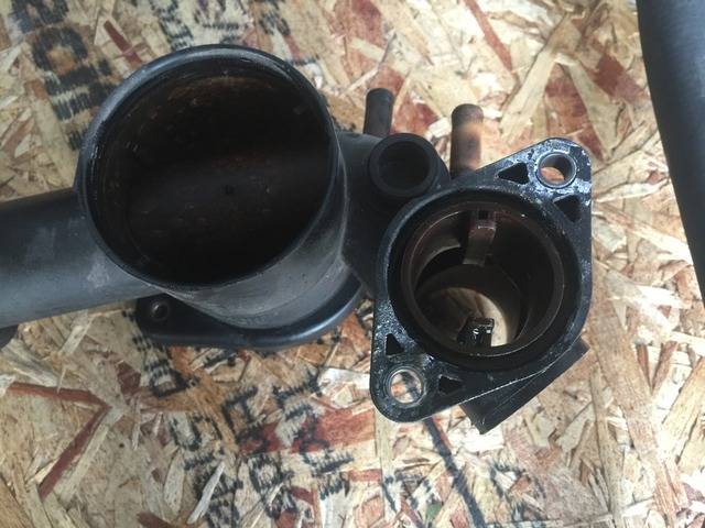

This is 2/3 of the thermostat housing. The third piece is still on my motor, because I have to buy some new cut off wheels to get the bolt out of it. I went the route of not removing my whole intake, though it doesn't look like it would be much extra effort, and wouldn't hurt to clean it and put new gaskets on. I may end up still doing that.
The part thats supposed to have a cap
The other side that has the cap

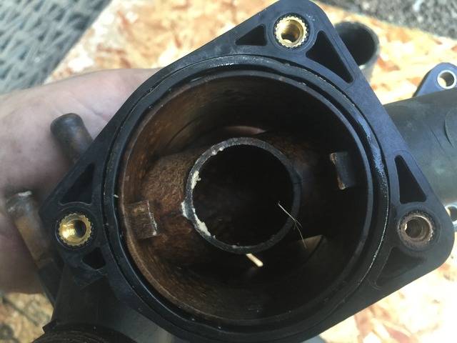

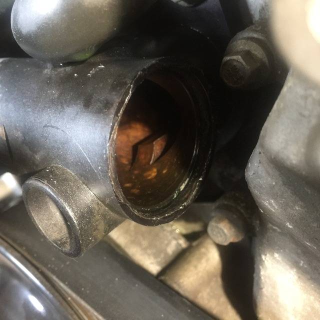

See what I said, the outside doesn't look so bad. Nice and black, fairly clean. Check out the inside
Check out those fat hoses...definitely not supposed to be that bloated looking

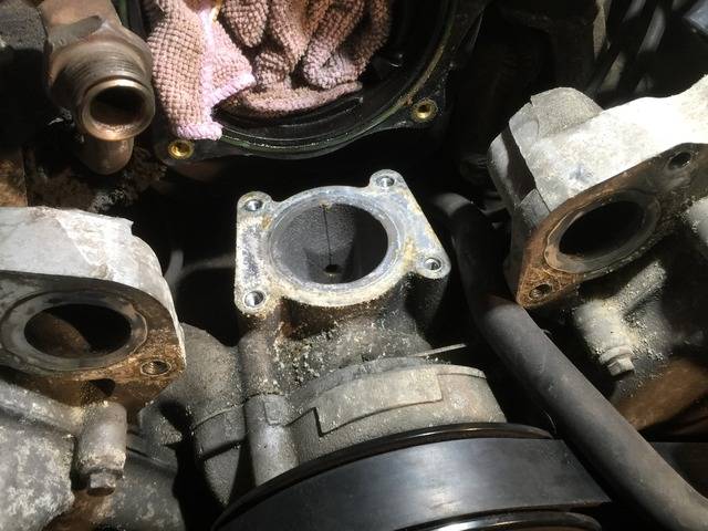

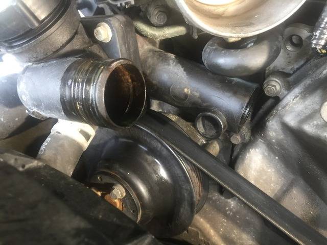

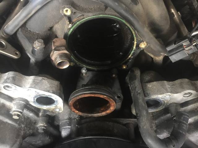

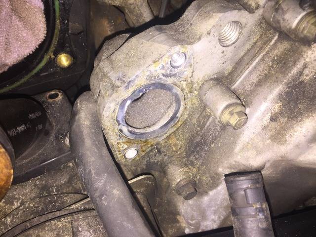

Now heres the inlets on the heads. Again, with everything in place, I saw no signs of leaking. Very apparent leaks now that the parts are removed.
And again, check out the inside of that plastic piece

All that browning on the insides is the start of the plastics deterioration. Complemented by repetitive heat cycles over time. It weakens and crumbles. No amount of "running un-pressurized" solves this common faith of the LS cooling system.

Additional info: (Wanted to edit this into the first post, but theres no edit option for some reason)
Here is that elbow I mentioned in the first post that was still on the car. I finally got to taking it off, and it was bad. Probably the worst part of them all. I am assuming my thermostat housing has been replaced at some point, but they skimped on this.
You can see how orange it is. That was with no flash on my phone. This next pic doesnt look as bad, it used the flash and really washed the orange color out.

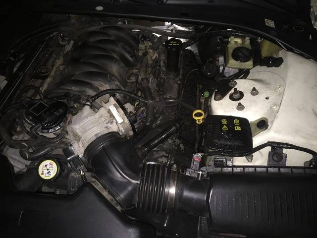

Here is my engine. You can see there was definitely quite a bit of leaking.
Yup, not that your pic is the first ever posted but as you can clearly see, the brown pitting on the inside where exposed to hot coolant is the beginning of the deterioration process. It's just the way it is in this particular application, no way around it.
Good thing your getting to it all now. This is why we always suggest replace all at once and refresh the cooling system, it's not that difficult, anyone can do it. Only a dealer job if you can afford to throw good money away.
