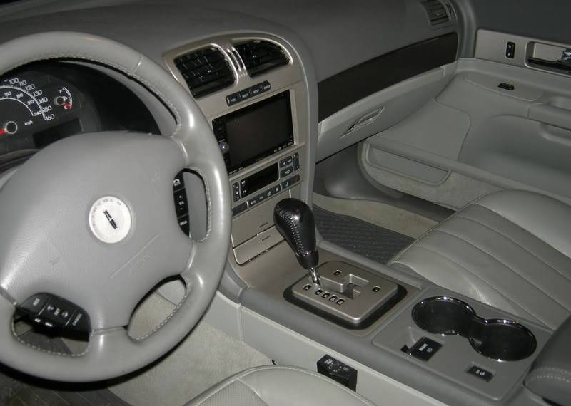

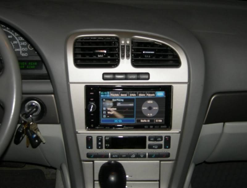

this wa a ROYAL pain but its finished. I wouldnt recommend this job w/o a dremel and cutting disk. The NAV bezel had to be cut a lot just to get the AVIC-D3 to come through properly. Ill get better pics tomorrow when there is more light out.

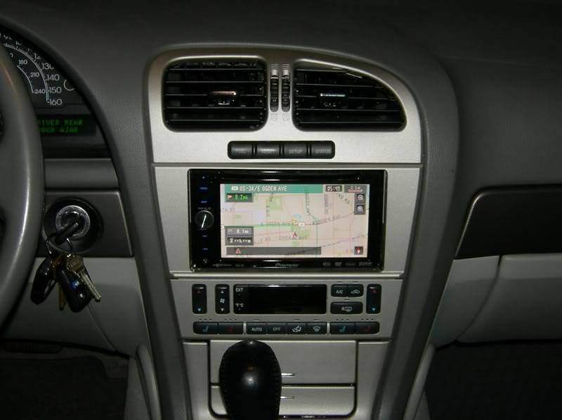

Here's mine, thanks to 02V8Sport:
Install was a SNAP since he had removed it from his car all wired up to the wiring harness and gave me the bezel. My sub now POUNDS compared to how it was set-up with the line out converter. Only bad thing is you lose the two speakers on either side of the console, but I'm looking into upgrading all of the speakers and adding another amp, so they'll be functional again shortly. :)
Still need to figure out where the one wire for the steering wheel control goes to, but I have a wireless remote so it's not really an issue.

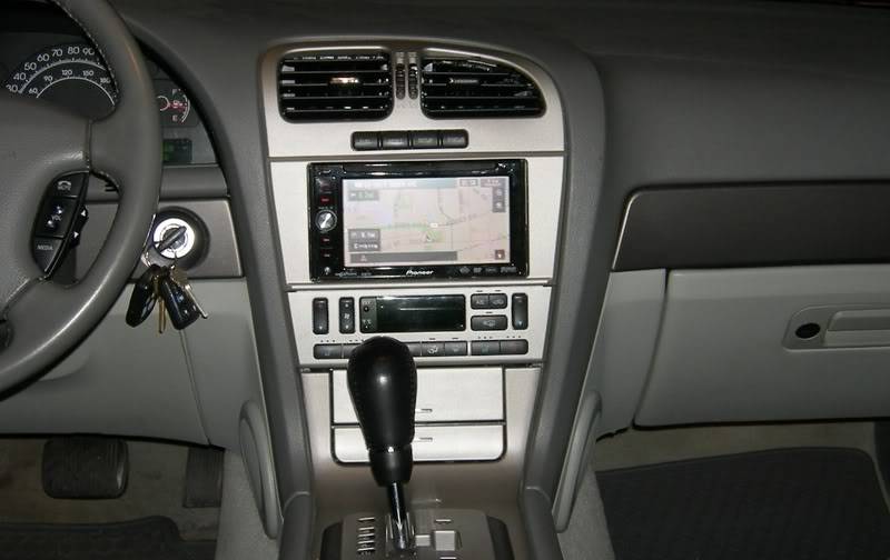

my d3 was 1200 installed with the sat radio and blue tooth i didnt do the steering controlls becuse im going to put in the paddle shifters. they use the wire spinny thing for the shifters also i didnt set my d3 flush into the dash my whole front window is tintedso being set back in the dash u can see everything without glare .also my factory radio was broken so i took the old radio took the face off dremeled it to fit into infront of the screen so if im somewhere i dont trust people i slide the face over the d3 so it looks like the factory unit!!!!

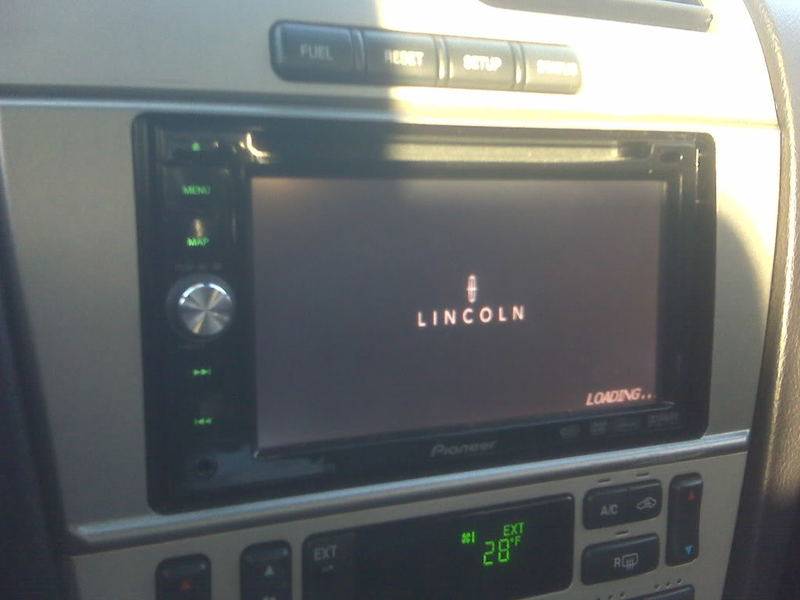

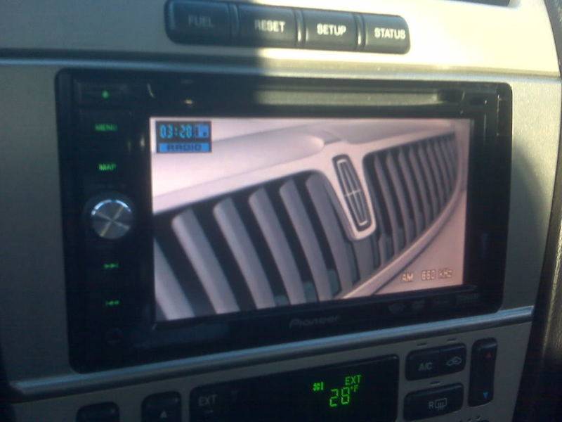

Recently upgraded to the Avic F900BT.
Initial notes: Easy upgrade from the D3, as the wiring harnesses are the exact same. For the video in motion bypass, you have to move the mute wire in the harness to another location (simple), and the GPS antenna connector ends need to be swapped from the D3 over to the F900's. (again..simple..requires the use of a small pick or jewel flathead screwdriver and takes all of 5 mins.)
Cons so far: -Unlike the D3, you cannot customize the background..just the initial splash screen. So your background is always a drab black. ugh.

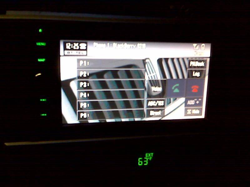

-Unlike the D3, you cannot control the phone/bluetooth volume from the volume knob, you have to use an touch onscreen + and - that appear when a phone call is active. This onscreen + and - menu block out some of the lower portion of the Nav screen while a call is active. Ugh.
I'll note more pros and cons as I go along. So far, I'm content with the upgrade, but not OVERWHELMINGLY excited about it. If it werent for the voice recognition (works very well, and useful once you get used to it) and the much improved Ipod interface that actually allows you to scroll through the music in a reasonable fashion (unlike the D3), I'd probably hesitate on going from the D3 with its larger screen..and more stable platform.
