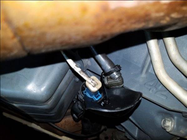

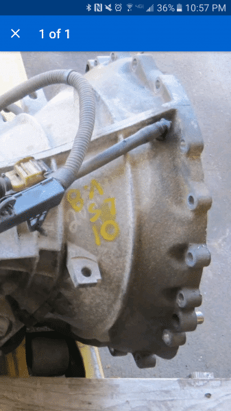

IIRC... this "breather" tube,,, is also meant as an "overflow" if someone overfills the tranny when doing a fluid change. The excess fluid will drip into the bellhousing... and if enough will leave a spot under the vehicle where the inspection cover is.
Therefore... you probably don't want to plug the hole. There are other reasons too.
I might get questioned or ridiculed about this... but ANY oil expands when it gets warm/hot. The idea behind the breather hose/tube on the 5R55 tranny venting to the bellhousing,,, is that it is protected from the elements... while still letting air in and out of the tranny. Remember,,, in the "old" days... transmissions had dipsticks and dipstick tubes. They weren't fully "sealed" as transmissions are nowadays... and allowed air to vent through the dipstick tube, (while still being sheilded from debris entering the transmission.
Thing is... fluid still expands when warm/hot,,, so there has to be a "breather/overflow" to let air move in/out with expansion/contraction of fluid.
Short answer... if you try to plug the hole,,, it will eventually shoot/push the plug out of the hole... letting in dirt, water and whatever else back into the tranny.
Soooo... what seems a simple fix by buying the part from the dealer... takes a considerable amount of labor, (and cautiousness), to install properly and fix the problem.
I'm not being a "jerk' about this... but rather being "straight" with you about the issue. Another way to look at this... is to be glad you found the problem now. Imagine driving down a road with "high water"... and sucking or pushing some of that water into the tranny. What would be the end result of that??? Most likely a trans replacement or rebuild to the tune of $1500-$3000. So be glad you found the issue now.
