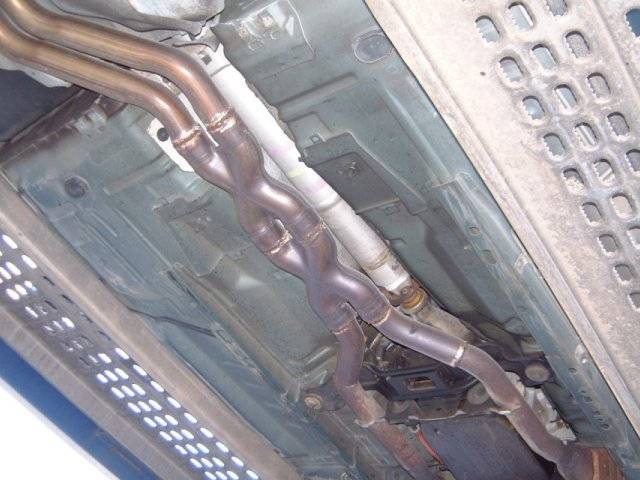

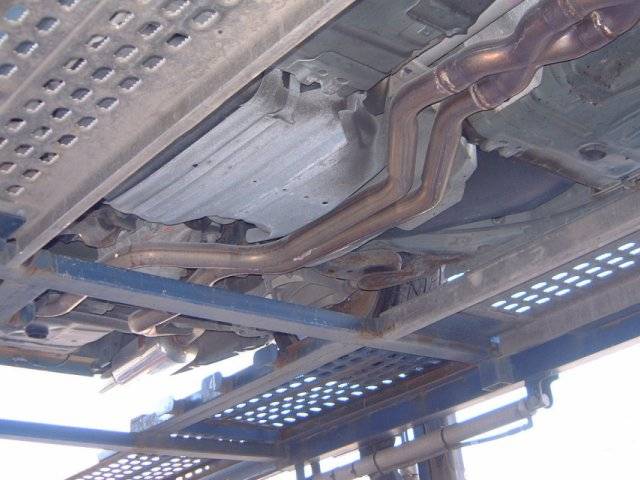

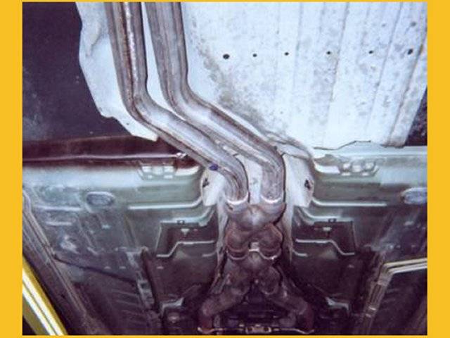

As with the exhaust you can look at the pix that I have posted as to what I had on the AssassinVIIIor. I hacked off the third cat and put 2 x-pipes and true dual exhaust all the way back. With JUST the exhaust my car ran a 14.4 down the quarter. Not sure what the car ran factory, but it was one of the quickest mostly stock Mark VIII's around.

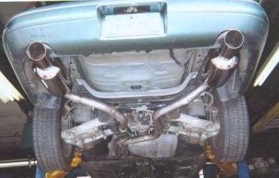

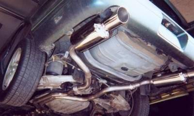

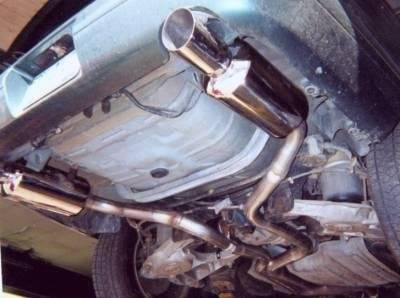

An earlier and slightly longer torque curve from having slightly more backpressure without restriction, plus the SOUND is so freakishly amazing!
Heres an example.

Ok What I want to do is so I would have the same setup as an LSC. I know that you have to bend the pipes but is it really neccsary to have two X-pipes. Do the X-pipe gain any power or is it just fro sound. I don't want to Increase the sound of the car but alittle bit is ok. After adding the duals, will it give me better gas or the same or worest?Would I need to change my mufflers to or can I keep the stock one?What a is the 3rd cat and all.I am not familiar with the exhaust components so bare with me.
It will gain MPG, our system has yeilded 1.5 to 3mpg better, the twin xx pipe lessens the sound, makes it more throaty and deep, with far less drone and raspyness. The entire stock system is crap the 14 chamber stock "hot water heater" mufflers are terrible for flow.The twin xx pipe as I stated in a post above increases the torque and the torque curve lasts a little longer and comes on a little earlier but the beautiful by product is the ultra exotic sound. Did you watch the COMMERCIAL?

:I the SOUND is freakishly amazing just with the mufflers, but will sound A LOT better with a whole system and the Y pipe gone.
