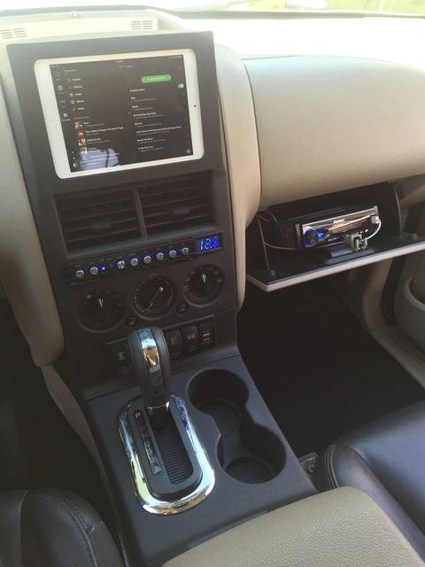

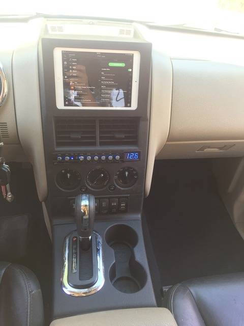

By the way, if I end up keeping this thing long-term, she will be getting the same treatment my Explorer got.
iPad Mini 2 in the dash, with a spring loaded slider kit
Head unit relocated to the glovebox, running a Pac IR extender so I can control everything with a remote as if the head unit was right there in the dash
I use hotspot on my phone to give internet to the iPad to stream music that I havent downloaded (Spotify), Netflix, YouTube, Pandora, etc.
I have an ELM27 wireless OBD2 module plugged in, and use the DashCommand app on the iPad to see all my vehicle data.
This was a stock gauge page, since then I have set up other pages with better looking gauges, with info that I want to see like trans temp, MPGs, speed/RPM, voltage, etc.
(Photobucket image would go here IF PHOTOBUCKET WAS WORKING!)
