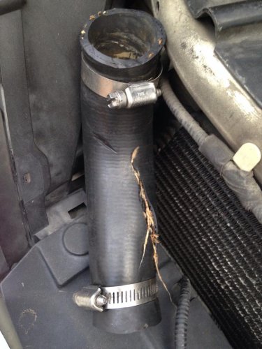

I went ahead and purchased the hose again as I need the car to get around (its running fine again). I did notice wear on the bursted hose though. I attached some pictures. It seems like the belt rubs on the hose (inner curvature) I circled which belt it rubs on and where the belt rubs on the hose in red circle. Also in the middle of where the hose has rub wear it has a small hole, apparently the belt rubs through. The yellow just shows where the hose "bursted".
So now I'm thinking, would that small leak from rub wear cause the system to have too much pressure and burst the hose?
The other hose thats on top of it seems to be resting on this lower hose. maybe it pushes down on it causing it to touch belt?
Sorry if it's a lil confusing. I will try to explain a lil better if needed. Thanks again guys.

It's not too much pressure!
You already see what the problem is, and yet you keep doing it over and over.
Get the correct OEM hose, with the correct spring clamps, don't cut it down (shorter).
Can't you understand that it is not supposed to touch any moving parts?
I had my hose burst in that exact Same spot minus the belt hitting it. Its a simple procedures but a pain in the rear. AutoZone had the same exact hose for $15 that worked like a charm. Take Joe's advice and get the oem hose. Yes it'll cost you twice the price but money spent well is money worth while.
I would have gone to the dealer after the first autozone replacement hose failed...
five failed hoses and you think the problem is anything other than a bad part/incorrectly installed...
IF the system was overpressuring AND the part wasn't crap quality AND put on correctly... im sure a different older hose would have burst before a brand new one would have (over and over)
hmmm, well to be honest I'm kind of skeptical about the oem hose since I did use it two hoses before this and the same thing happened. The oem hose popped from the outer curve though and had no signs of rubbing (that I remember) so I didn't buy the oem hose again since the same thing happened with this more expensive product. What I do remember is trimming the aftermarket hose because when I compared it to the oem hose, the aftermarket was a bit longer and looked kinda kinked when installed. As far as the clamps, they screw clamps have always been there but I will get some spring clamps. So now I'm thinking that the aftermarket hose will clear things better in its full length?
