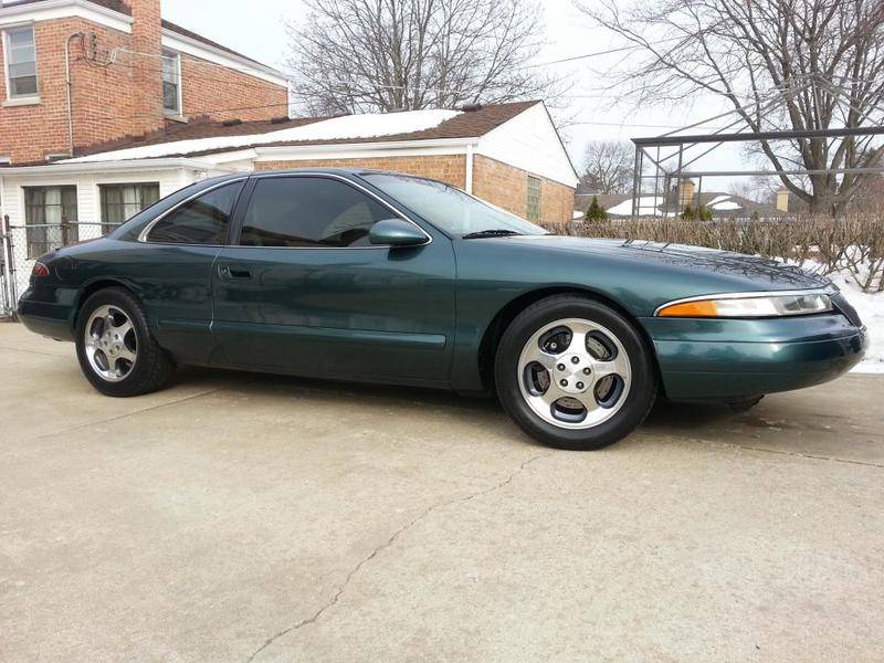

Final setup with the strut mounting holes re-drilled and isolators on the top and bottom out the rear springs. Went for a drive and I'm pretty happy with everything except the alignment. lowered lincoln.jpg

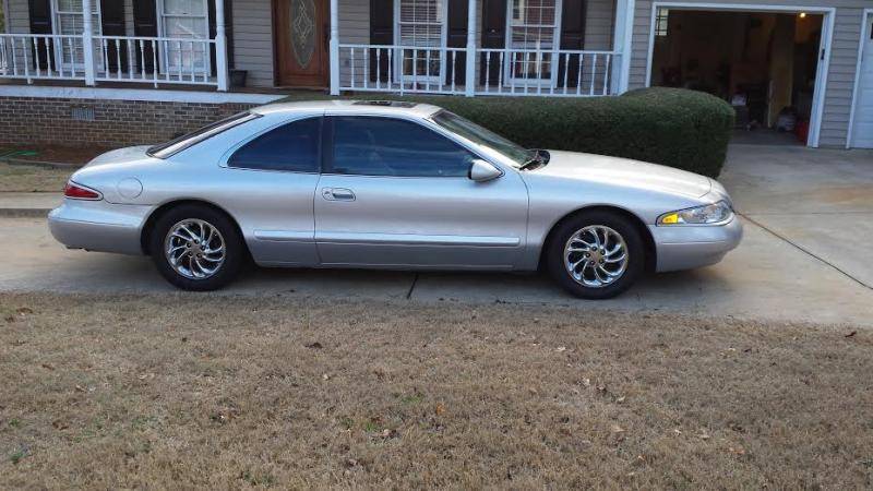

Bought my Tokico spring and shock kit from amazon a few years ago for under $500. Came with front and rear shocks and front and rear 1.25" lowering springs (i believe the ones that chris has). Also bought the rear perch set up from DLF when he was alive and prothane isolators. Rides great, not too stiff or too soft. Here's how mine sits.
