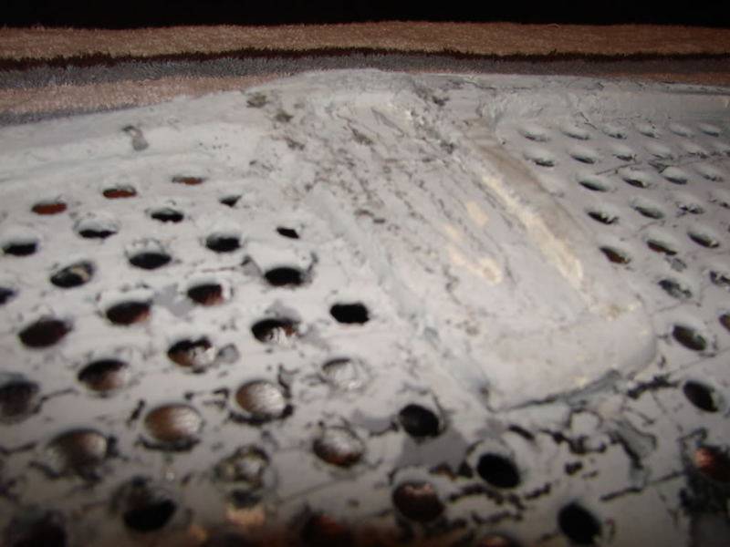

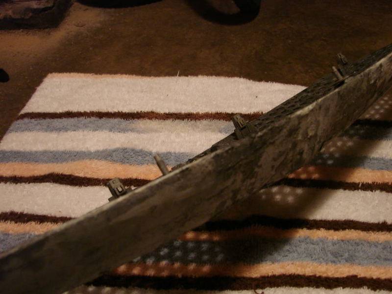

Long story short, my mclaren grille was the victim of some aircraft remover. Genius that I am, I thought I might as well remove the remaining paint and have the grille repainted, as it didn't match to begin with. Well what ended up happening is certain areas of the grille actually melted.
Anyway, I'm hoping to start fixing it up this weekend so that i can use it again. I was in contact with LSdarkshadow to do some fiberglassing for me but with shipping back and forth it didnt seem to make sense.
Please don't tear me a new one lol just need some suggestions as to how to go about fixing it. Bondo? fiberglassing? or is not salvageable?
It was a disaster, cover your eyes if you have a weak stomach lol:
Main damage is around the area where the emblem goes, and the top edge of the surround.
Ouch.
Easy fix, lots of sanding and fill it up. The damge doesn't look too bad, the grille as a whole looks terrible, but the damage doesn't.

It looks pretty chewed up, but it is hard to tell for sure. Sand it all down as best you can with 400 grit (or less), hit it with some high-build primer, and then it will be easier to assess.
well if you don't want to put the work in I surely will I love fixing things most people wouldn't I just fixed my grille a couple weeks ago
id start with a sander and even out everything, then bondo/fill any cracks.... a dremel with a fine tip will get into the corners. I successfully filled a chrome bubble when painting my grille, you should be able to salvage this

Personally I'd coat it with a thin layer of bondo glazing putty wherever the surface is pitted and sand it down from there then primer, then sanding

You can probably get a better picture of the damage if you give it some rough sanding and prime it. The jacked up paint probably make it seem wose than it really is.

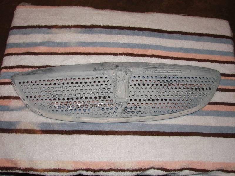

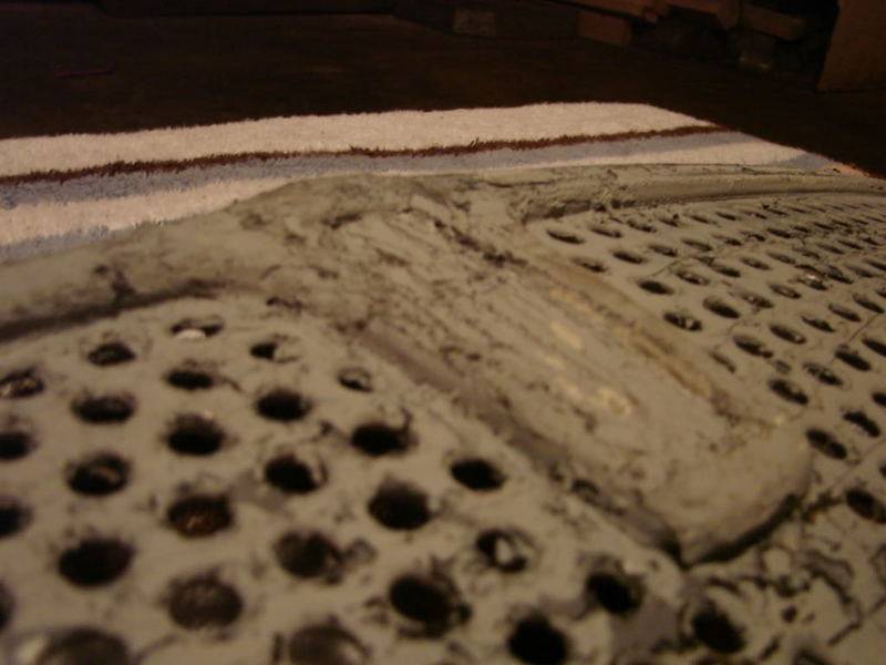

Quick update
to all those pessimists, glad i didnt listen to you :p

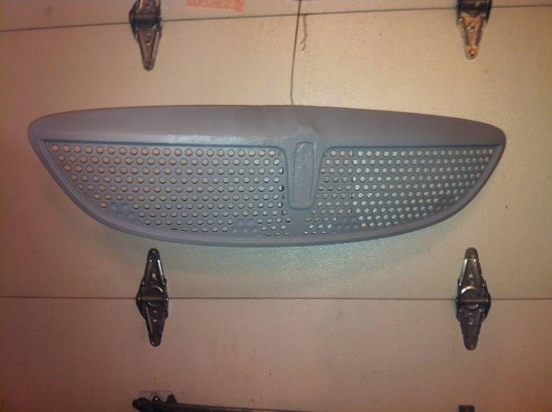

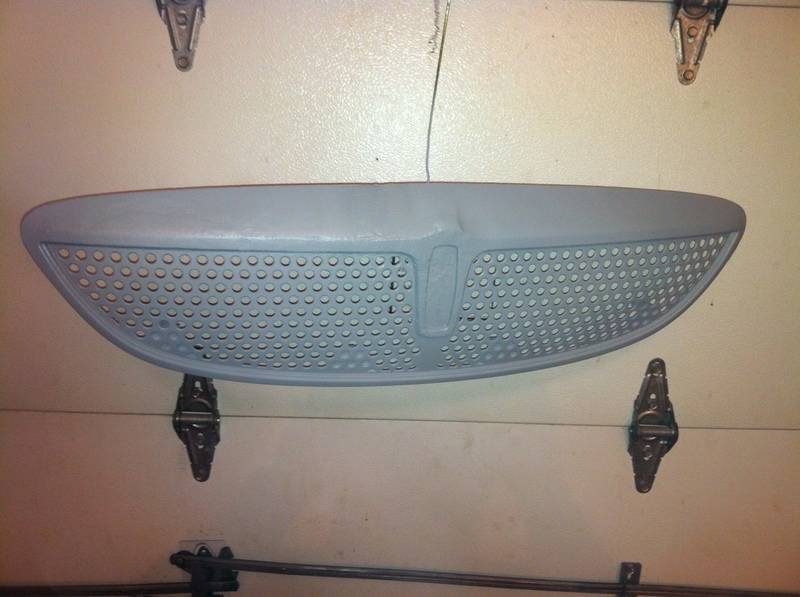

scraped most of the paint by hand, sanded, flex primer and then filler primer...its looks much better IMO, but still much more work to do. I have hopes that when its done itll look ok. I'm not saying its going to be perfect, but it will be usable...def not for the perfectionist.
By the way any recommendations for a good filler to use on this type of material (plastic)?
These are after only a couple of coats of flex primer and filler primer (ran out). Will do a couple of more coats then fill and sand.
wow that does look way better, and you will want to find a light glaze filler or you will be sanding for days
