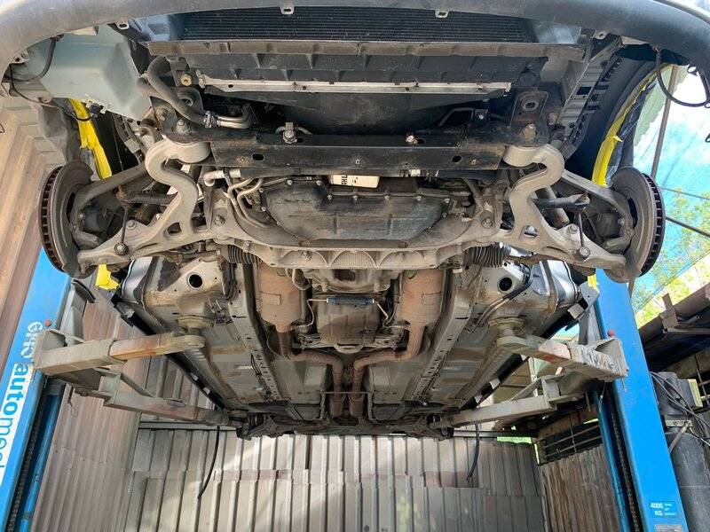

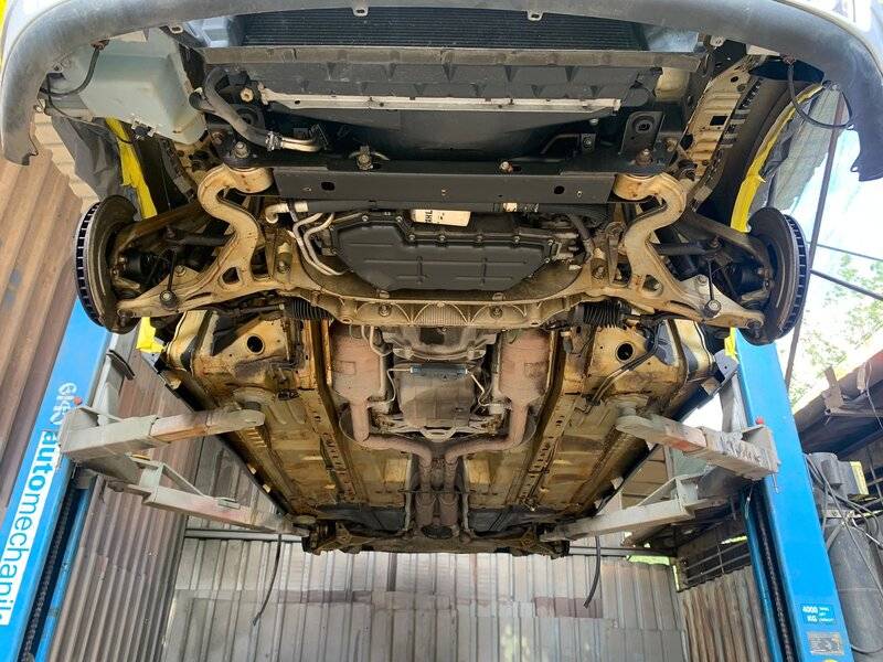

After owning the car for a while i am positive i will keep it, so i decided to take care of the chassis to make sure it will serve me a long time . First two pictures are before the treatment after the wash. The last two are after the car was treated.

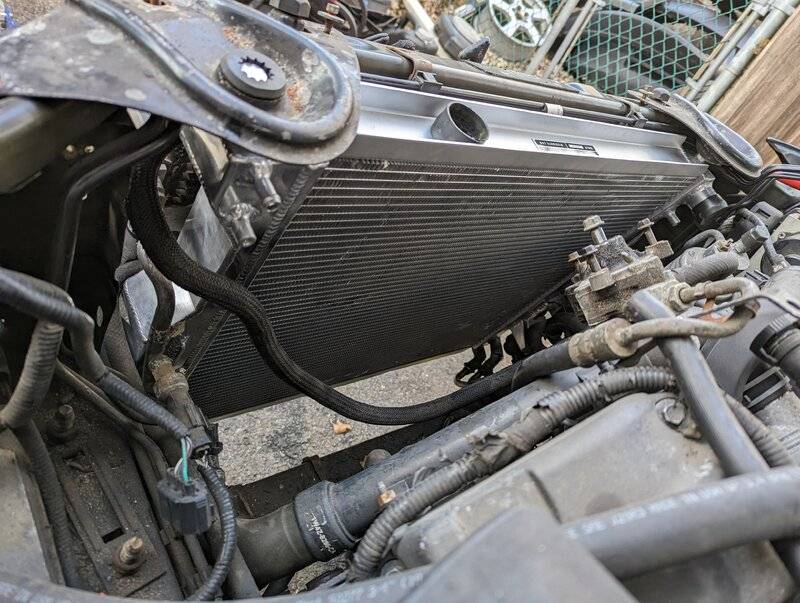

Still working out this 05(-14?) Mustang all-aluminum, bigger than stock-LS radiator. It has physically fit so far with AC and the gen 1 hydraulic fan. First bleed did not bleed at all so I drained it all. I'm working on an adapter bracket for the modified lower mount since it's sagging on the passenger side with just a hacked mount. It needs adapter hanging brackets for the coolers/condenser. Fun fact: the gen 1 combo cooler is actually 3 circuits: it cools the hydraulic fan fluid too! Not fun for fitment
Edit: this is of course following the footsteps of DeviLSh from around here in the thread
