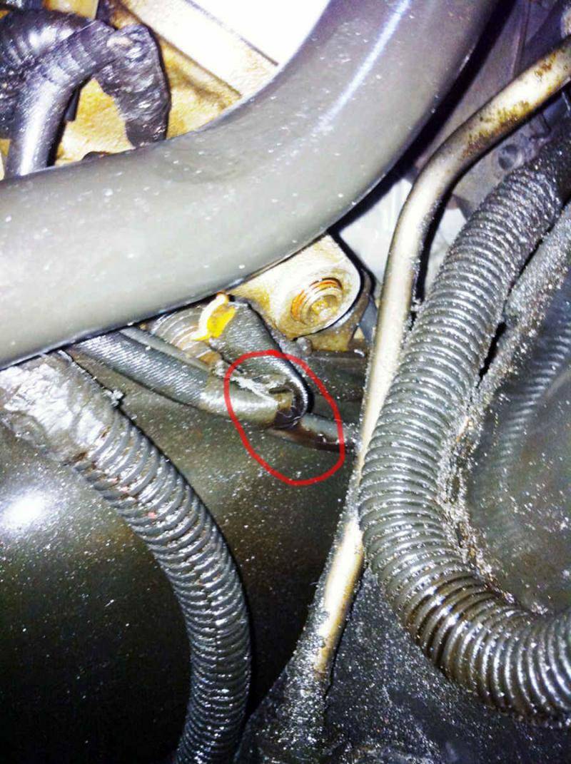

I could be wrong. After changing the oil tonight, and cleaning up the oily mess from the leak, I'm even more baffled about where the leak is coming from than before.
After starting her up, and waiting about 5 minutes of idling while under the car, it seemed to be 'oozing' out of one of the wiring jackets. Oil is not falling onto it either. It's coming out of this jacket. WTH??
The area around the actual oil filter adapter is dry, so I'm fairly certain it's not leaking from there.
Anyone?
The sender unit is a 1 wire electric sender. It's basically an on/off switch. They do leak quite often, but if it's not that, then possibly oil pan gasket, or oil filter adapter gasket.

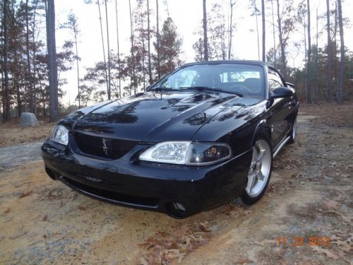

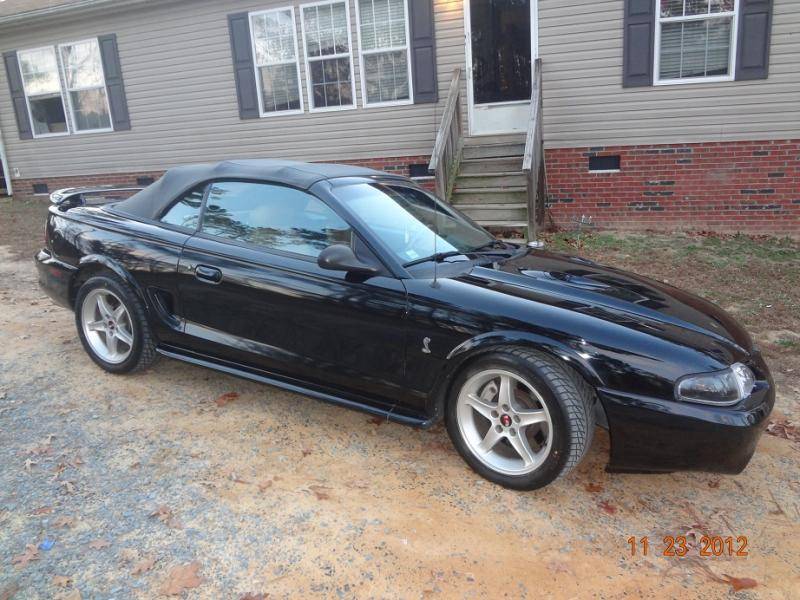

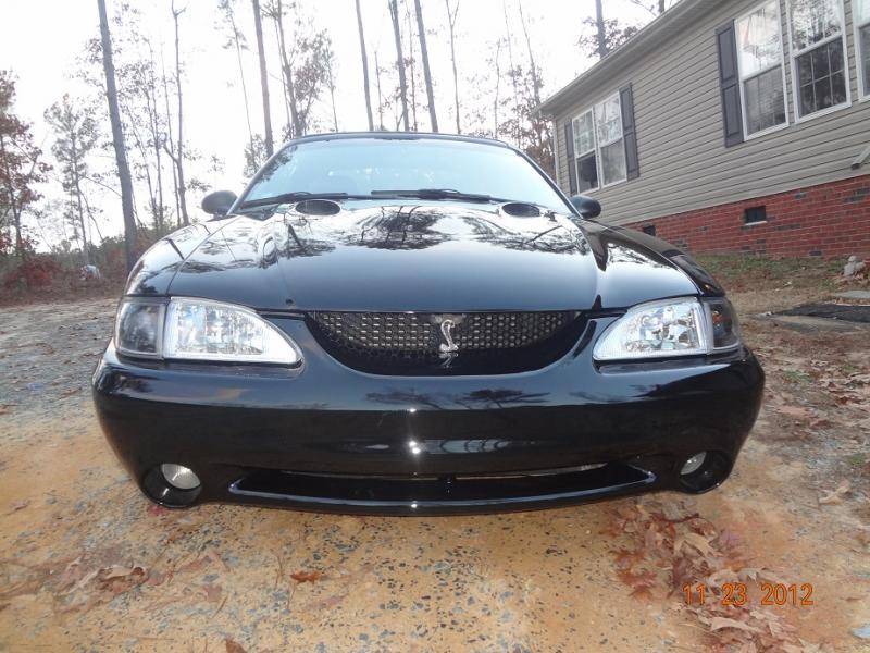

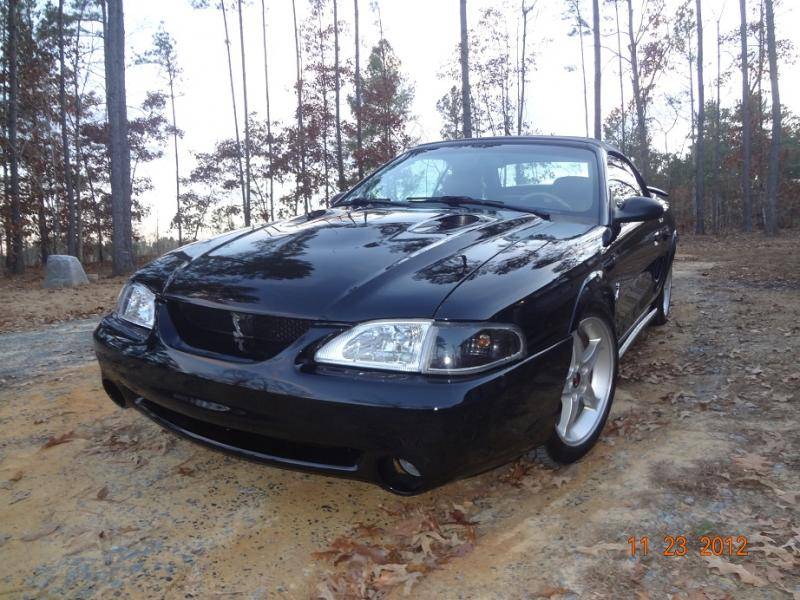

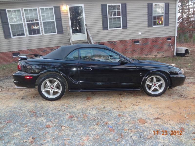

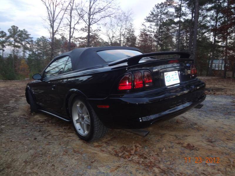

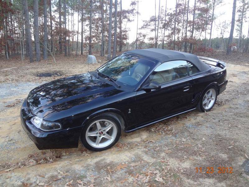

The Cobra is fixed! Finally! Looks pretty good too:)
I will be going back to the body shop Monday or Tuesday to pick up the old front bumper cover, headlights and parking lights, and the (new) hood they didn't use. They couldn't use the new hood because it was damaged during shipping and (they said) the freight company wouldn't let them send it back because they took too long to report the damage. So I have a basically brand new Cobra hood that has some chips on three of the four corners. It's primer white and ready to be used. Anybody interested, send me a PM. I'll post pics when I go pick it up.

had the mechanic put on muffler tips, he also built an X crossover and cut it in; washed the car then "Nu-Finish"-ed the hood, roof and trunk...plasty-coated!
Now it's right. :D
pics to come..he lowered it before I could get a photo of the x- crossover....he also stood by his position that the crossover is insignificant on an un-tuned exhaust system, I think I can tell a difference...less 'flappy'?
DNS your exhaust guy is sofa king we todd did.. I bet it sounds much better and probably has a tad more pep.

Saggy, its either the OPSU or the bung stop in the adapter housing . When the OPSU goes bad, those things leak like crazy, but they're only $3-$4 in the "Help section" and take less than a minute to swap.. TIP- have your new one out of the package and ready to install before removing old one. Make sure its threads have sealer on them. Remove the one wire-its just a press on. Then loosen the sensor and slightly back it out. Oil will pour out of the hole its screwed into, but if your fast , you can do it without loosing hardly any oil
