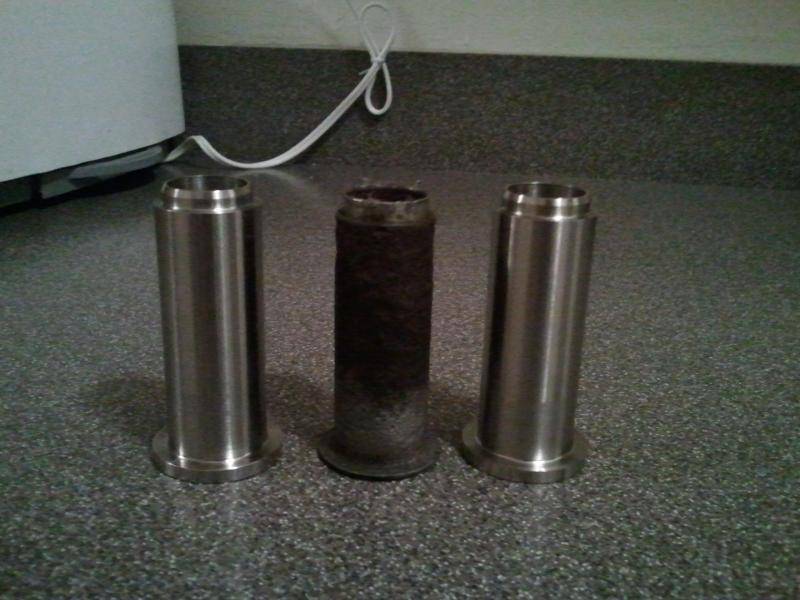

OK, I think I'll have no problem making spacers for the front SRB's, this link was more then helpful! I'm gonna go with the stock ford bushings that everyone suggest.
Do the rear SRB's also have a spacer that needs to be changed?
Trying to collect all my parts before tearing this thing apart.
Ok what I guess I meant was...Is there a sleeve in the front SRB's to the K-member? Or are the bushings just sand witched between the washers?
Do you leave that back nut alone when taking it apart and slip the new bushing's on and re-tighten the nut on the front? So to keep the rod as close to where it was before taking it apart?

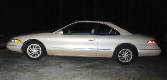

first test drive for the white one on coils; feels okay so far, i think I hear some clunks from the front end though...i still need to cut a wire to be rid of the display center air ride message...finally glad I bought this car

The spacer gives the proper preload for the front srb's

OK I read both link's again and it look's like there both for the same bushing....the forward SRB...correct? Why is there .200 difference in the two?
And does anyone have the spec's on the one that goes through the LCA?

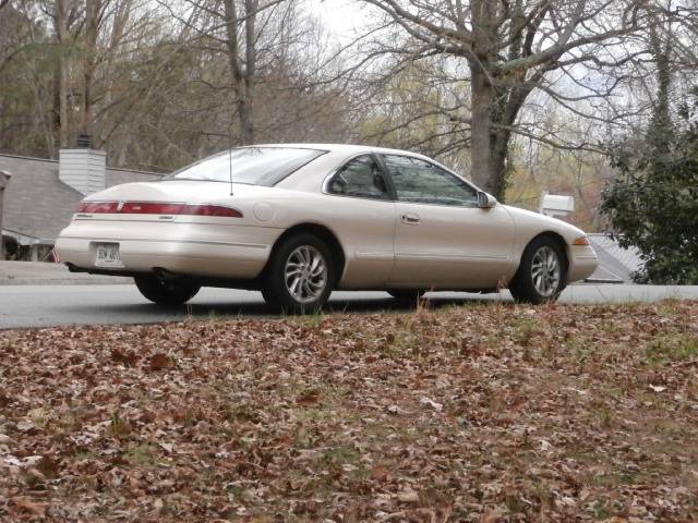

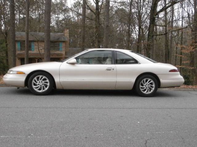

well I just worked 2/3 of the day so I got home in time to see the white one in daylight and test drive it again...these pics are on a mostly level and flat surface,,,I could lower the rear a little, or not?...

My 2.6" dimension is the same as the factory space
Once the spacers are on the the distance betweent them would be about
2.4" (iirc the spacer is .200 thick )
As for the rear srb's (to the control arm) you won't need to make anything
Ford still makes them.
