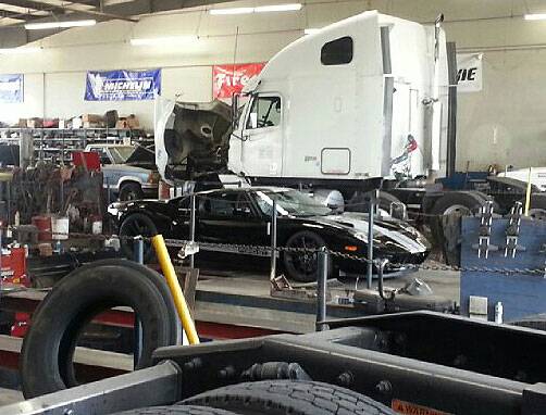

The torture of waiting for this hot little number to vacate the pit so I could have my car done was... painful. 1100 miles. Black on black.

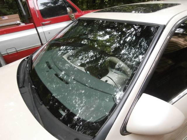

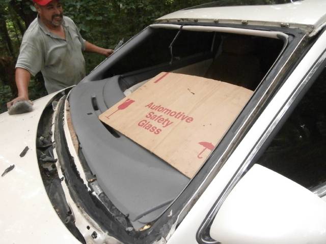

had a new windshield put in the white one

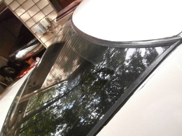

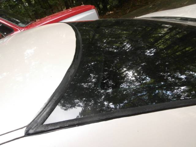

---he also trimmed the remaining overlap from the back window and filled the gap...it doesn't look great, but it looks better

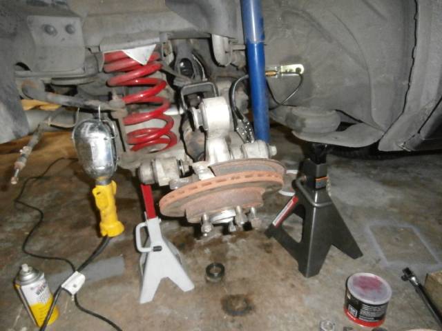

for the brown one, put the new/used half shaft on the pass side... should the LCA bolts be torked with loaded suspension?
remove the stand from the sub frame and just have one under the LCA?

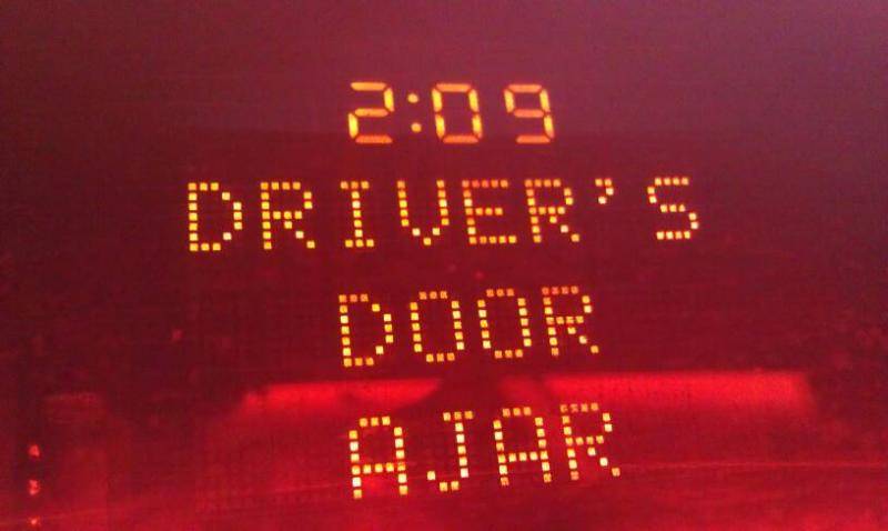

For those wanting the pic. I sanded the blue filter off with high grit. Then removed the smoke filter from the trim and out a red filter on.
Any chance you have pictures from this job? Would like to see how it was done so I can give it a shot. What filter did you use? Would like to get blue to match my dash
no pics, but a blue filter from ebay, about 3 dollars 20" x 24"
its really easy, remove the message center button assembly, then the headlight switch trim, then the screws above the cluster, and next to the headlight switch, then pull the big trim panel off, making sure to be gentle, yet forceful to pull it out of its clips.
After that, there are four 7mm screws holding the message center in place, unscrew them and pull the message center out.
there will be 4 T15 torx screws holding the front black plastic onto the message center, remove those and pull the bezel.
Using 2000Grit sandpaper, sand the blue filter off until the glass looks clear. Wipe with alcohol pad (or qtips) and apply your color filter.
Reassembly is the reverse of assembly
You didn't use any isolators with your springs?
this is the std Strutmater kit per AAS, a square of sheet metal with bent corners and a small stud in the center for the upper locator/perch, no isolators or bottom perches...I doubt the coil base has move 0.125" in 25k miles...
