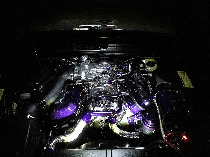

Finished my little LED engine light install that I thought was going to take a couple of hours. Oh ha ha. I was able to run the hood light wire through the hood and then added a connector in case I need to remove the hood (Gonzo upgrade). I used cool screw type LEDs with pretty wide angle lenses. I think it only took me nine hours, too. Nutball in the 103 degree heat.
That looks really nice. Would you make a separate thread detailing what you
did? I wanted to do this on mine but I did not like seeing the LEDs exposed in plain view. Looks like you accomplished what I had envisioned.
Do you have your lighting coming from above and in front of the engine?

That's exactly what I did. I used these in black with the cool blue bulb: http://www.superbrightleds.com/moreinfo/led-accent-lighting/bolt-beam-12mm-led-light/1494/
I drilled a hole just behind the upper latch in a slanted part of the underhood that kinda faces the engine. It worked perfect because it gave me room for the length of the lite and the wiring, but doesn't interfere with the latch at all. With a fair amount of luck, I fed the wire starting from the latch opening to the left corner and pulled it out through a hole. I then fed it back in the same hole, but downward towards a hole that I chose next to the hinge. I couldn't get the wire to just turn the corner, so this worked. Then I fished around at the bottom with a little hook tool and the wire was right there! I put a connector in right next to the wire channel/big grommet and used some new headlight connectors that I had left over. I have a hoodliner coming :D. I also cut the base off of a new Dorman emission tee and created a grommet for the hole that I chose and it worked perfectly.
I actually used the covered wire channel for this since it's 18 awg and proceeded to protect it to the radiator. I ran it through the channel on top of the radiator and just below the beauty covers. I chose the two biggest holes and drilled them out to fit the lights. You don't have to take much and the aluminum is pretty thin, so it's not bad. Each light fit perfectly there facing the engine. I just put two there, one on each side. Then down the way towards the battery, I installed a switch. I have a little fuse holder with a 5 amp fuse that I will probably install down the road. But with a switch and LEDs, I'm not too paranoid about it. They won't be used much. I will take some pics of the wiring and routing when I become a little less warn out. I think the brightness and style of lights is perfect for this application and you can't see any of them!

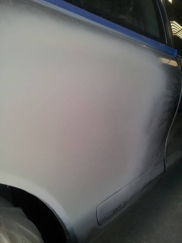

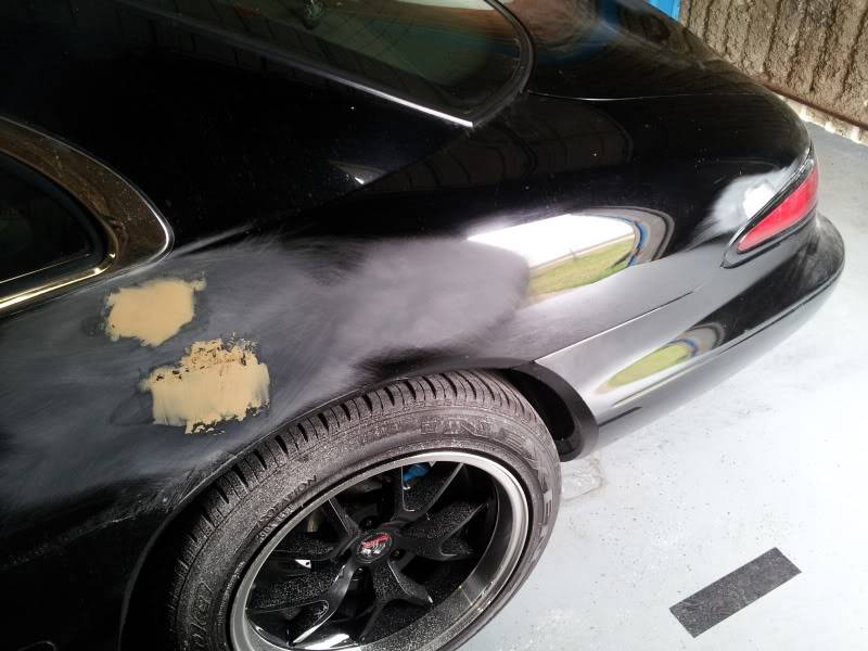

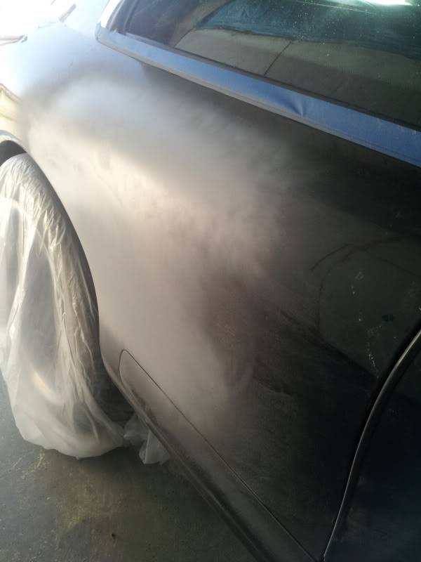

It'll sit in primer for a week or so. Right now im just smoothing everything out with finishing filler then a quick shot of High build and then a light scuff with my new sanding block and 120 grit to show any high/low spots
The dent that was on the passenger 1/4 is all but gone ;) A nice sanding block makes a world of difference
