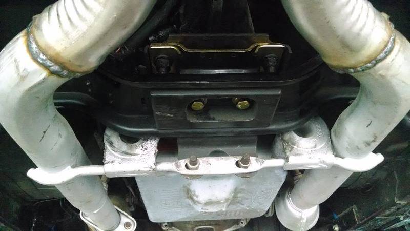

Installed the transmission mount.
Note, the Energy Suspension mount is NOT completely plug and play. You have to slightly enlarge the mount holes plus you have to slightly enlarge the slots on the cross member in order for the bolts from the cross member to mount to line up.

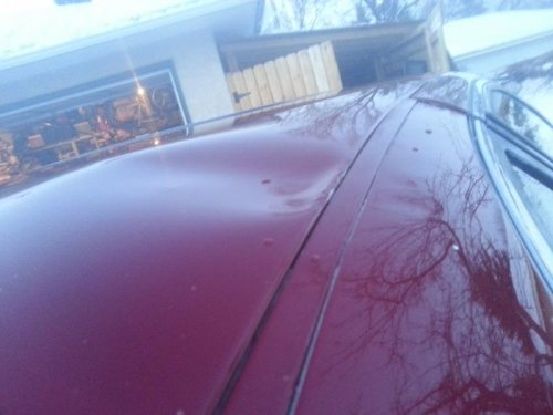

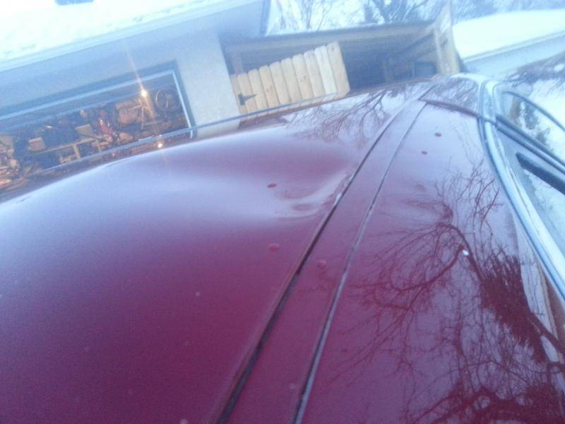

Home owners Insurance by any chance?
Mine bolted right up. No modification at all. I bolted the mount to the trans, then place the bolts throu the cross brace only a couple threads. Then put the cross brace at rocker panels bolts in a couple threads. Then run the lower mounts bolts up tight followed by the cross braces bolts at rocker panel. Easy
I think this was bad a little bit
All better.. Yay
That's exactly the way i did it also, except the separate mount brace (the one labeled not a spacer) would for perfectly but the transmission mount bracket wouldn't go up. It wasn't quite spaced right. I had to enlarge the holes. Also, the cross member to mount holes were off by a bit too. I had to force them into place, slightly tighten them, then put one cross member to frame bolt in loosely and pull the other side hard to get the bolt to frame to lime up.
Definitely an interesting experience and my old one was definitely a bit worn also lol.
You lubed between the Pre-Load plate and Bushing didn't you?
The plate and the transmission mount? I didn't lube anything.....wasn't aware I was suppose to.
Care to elaborate?
That little tube of lube they provided as seen in my picture, should be spread on the 2 little lobes facing up as it sits in the car. Those lobes will squeek on smooth roads if not lubed prior to installation
Well......I didn't get that in my kit. That sucks, lol. I wonder if I should contact Jegs and complain. Not that it would do me any good, because there's no way in hell I'm taking that back down again lol.
Does that kit not come with instructions?
