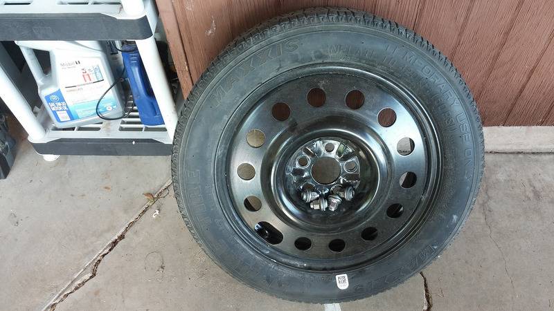

About the lugs, after seeing how badly beat up there were on the car, 2 were rounded completely, and one the lug erupted through the end. I mounted the tire to a Thunderbird and all 4 lug nuts tightened up completely, but the studs are longer on the MN12/FN10 than the looked like on the LS. Especially with a pretty thin wheel, not 1 inch thick hub like my aftermarket wheels. 611-117 seem like the shoulder that goes into the wheel is too long, the wheel isn't that thick, but the regular wheels seem to be.
