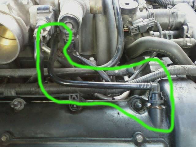

I think the O rings in this thing might be getting bad because there is signs of leaking oil around this.. Any suggestions on where I can get it from or what its actually called so I can order a new one. Thanks in advance
Could it be a PCV valve on the V8? it just looks like its in a good location for it
Its $32 from the Lincoln dealer. None of the parts stores around me had it, it was a dealer item.
You could just replace the o-rings in it if that is what is leaking. Mine was leaking where it connects to the valve cover. It was the part in my valve cover that was actually leaking. I just pulled it out, cleaned it up, and put it back in using RTV.

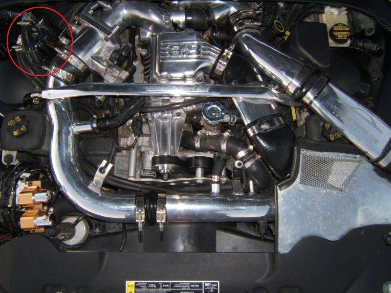

is there something stopping us from replacing the "tube" with two small breathers so we don't have contaminated warm air going back into the intake?
or maybe even just one breather on the valve cover and plug the other end?
and also doing the same with the other side right after the MAFS?

lol...but seriously i'm not a big fan of having my engine breathe contaminated air out of the valve cover. and that air has got to be pretty warm coming out of the valve cover
or..maybe i'm thinking about it the wrong way and it's sucking clean air into the valve cover...but probly not because then we wouldn't have problems with oil leaking there

no i looked at it before, the inside of the valve cover is like a metal screen in that area, so i guess it sucks hot air from the VC, it may have some use- like if the fumes are still there and can be burned for combustion, it recylces it, im not sure the real purpose, but i dont understand hot dirty air going into the intake either, but it must have some benefits as long as oil isnt being sucked in too
