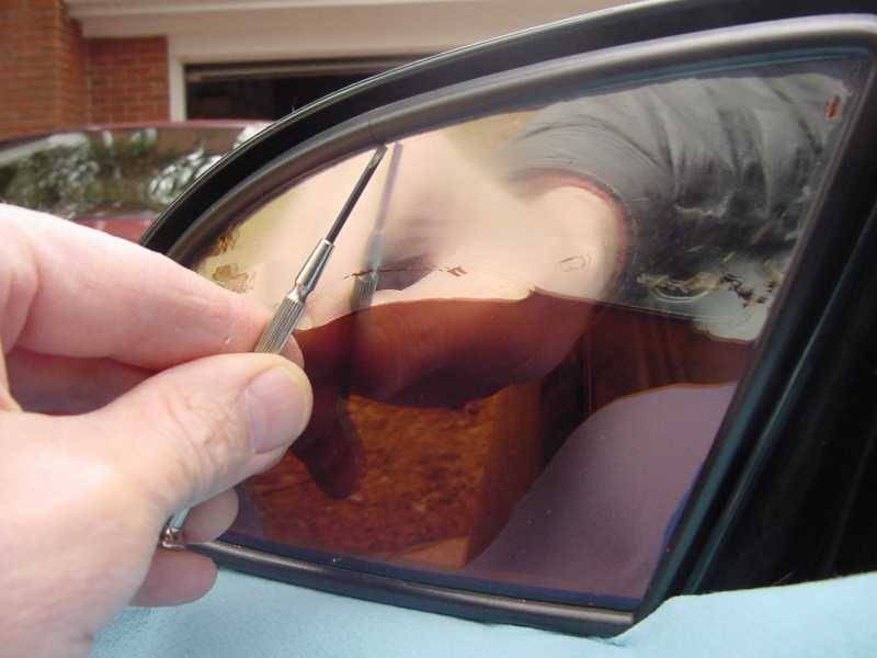

I used a screwdriver to push the plastic seal/rim of the glass up and away from the glass, near the gap in the seal.

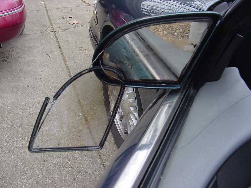

I carefully worked the seal off the top and sides of the glass. Be careful the glass is sharp. Then I separated the outer glass from the mirror. I used a rag to wipe the fluid off so it wouldn't get on my paint.
Then I cut the wires and took the seal off the glass. The seal broke in 1 spot so now it's in 2 peices. I'll glue the seal back on and seal it when I get some black silicone sealer.

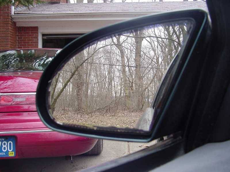

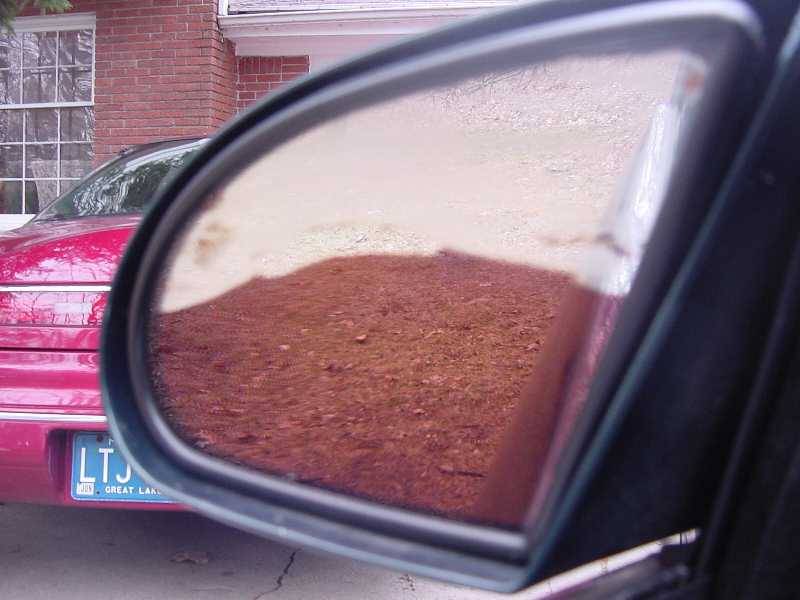

You can see in the photos that the edges still look bad on the mirror but the seal and silicone sealer should cover these up. I'll add another photo when I finish the job. The mirror is nice and clear otherwise.
Here's some photos:
