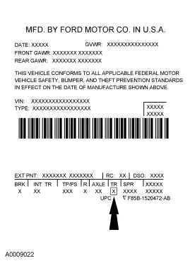

This shows the position of the trans code on the door sticker, there is no trans id in the vin number, only engine.
A = 5R55S
and suprsingly enough...stupid ford motor company uses the same code on 02 fo the 5R44N so its pretty useless lol
5 — 5-Speed manual (M5 221), Getrag
A — 5-speed, automatic (5R55N), Sharonville
well this just gets weirder. my door jamb says trans code A. Is there a tag on the tranny???

I checked your vin online with Ford. It says you have a 5R55N
They are using ths same id code for the 5R55N and 5R55S, Ford = Stupid haha
