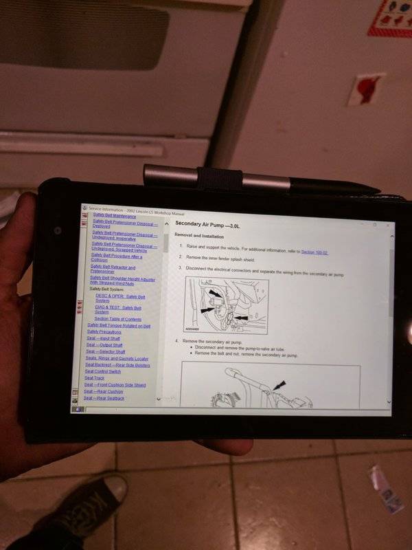

You can tell it predates the existence of touch screens but it works okay and I think the form factor is really nice. Was just out replacing the smog pump on my 02, had the tablet under the wheel well with me.
