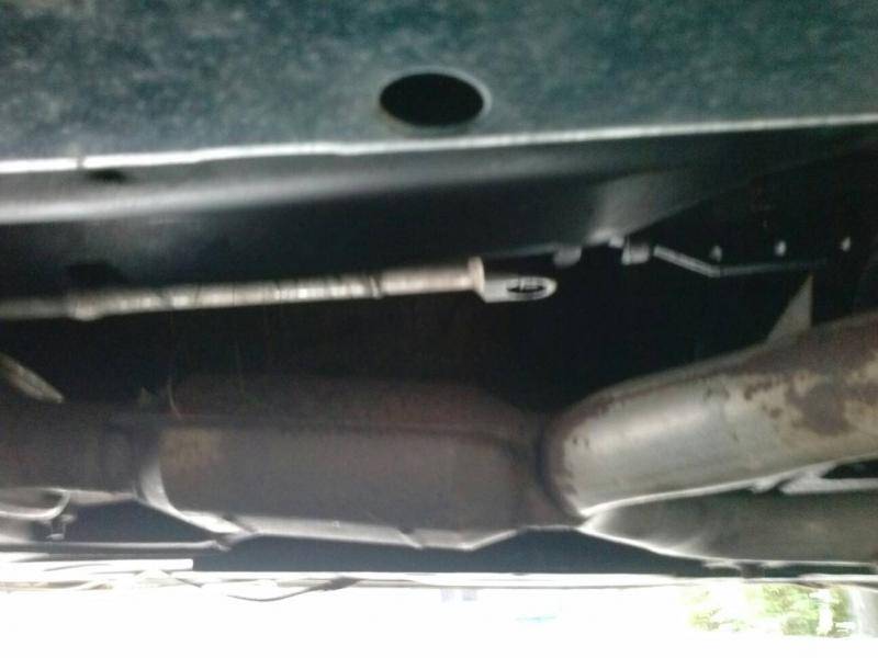

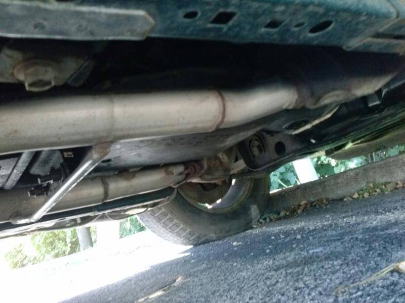

where should i cut the third cat off to put in a x pipe the easiest
Yes. Get rid of that third cat. It is completely useless. And you can sell it on fleabay and make enough to pay for the true duals :D I used an H-pipe on my '97 but a lot of folks like the X-pipe. Either one works.

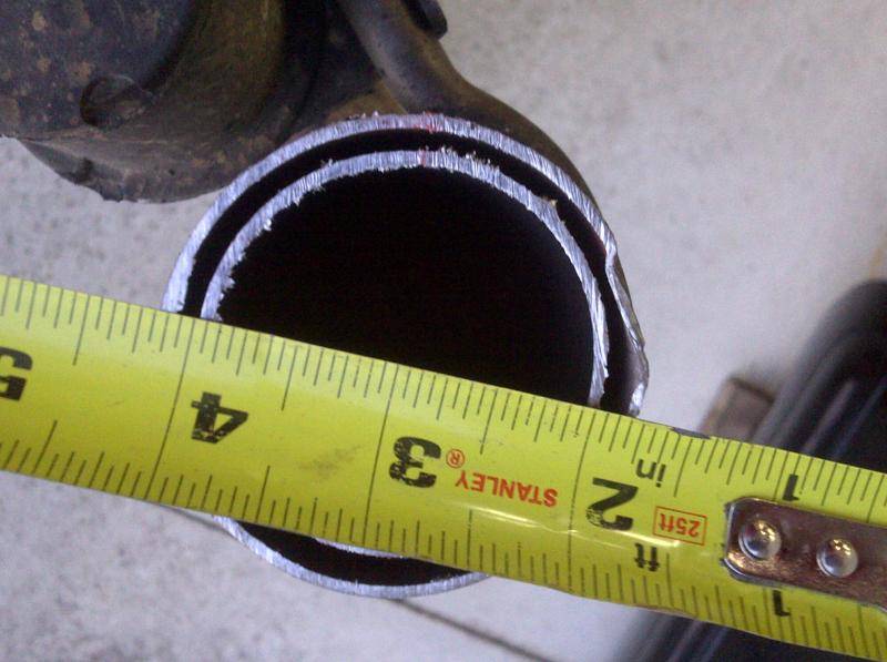

The stock piping in the trans area is not even 2" because it dual walled.
If you connect it all the way in the front, just buy the S pipes they sell with the x-pipe and use that too unless you have one preferred to buy. I would personally cut it close to the two cats and then run it.

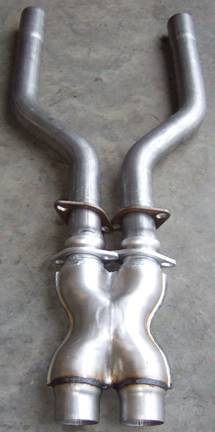

Get this kit too and then you'll know it was done right. $155.00 304 Stainless Steel, 2.5 Inch, Standard X-Section unless that has changed. I don't even know what size pipe you're going with.

If you get the 2.5 Inch, Standard X-Section with S-pipes, that will have you cutting well away from the 3rd cat and also getting rid of the small OD area in the bends before it goes into the 3rd cat. All of that would be eliminated. If you have a shop in your area, find out if they have a mandrel bender. It might be cheaper for them to do it. There are no mandrel bend shops around me anywhere. The shop will know right where it needs to be cut.

What I'm saying is that if you get the S-pipe kit with the X and the other kit you were going to get that goes from where the X would be, all the way to the rear, that would be enough. You would have much more opened pipe through out the whole system. The only thing you would be left buying would be mufflers and tips. I would find out if a local shop will do it and if they have the capability of mandrel bends before buying anything. Maybe they can do it and you furnish the X-Pipe, mufflers and tips.
