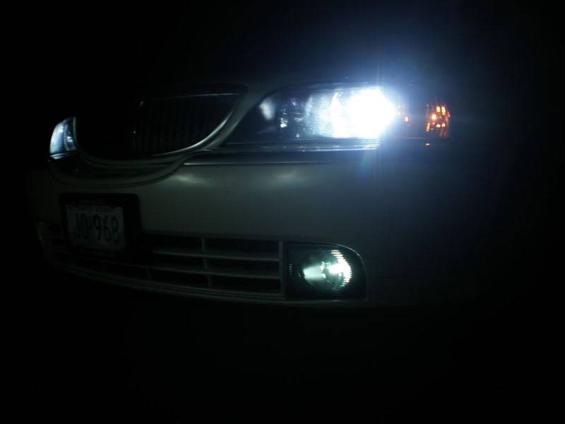

here is a pic of mine 6k with 55 watt
the fogs are LED... looks kind of off in this pic but looking at them in person they match perfectly
They look good. Are you using projectors?

nope stock headlights

higher wattage causes some color loss, if you look at my picture above thats 6k@55 watt
