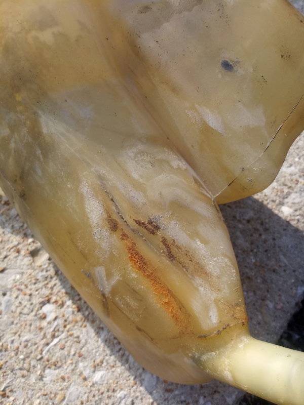

My coolant bottle looked exactly the same and when I replaced it, I replaced the thermostat, coolant, and bottle together. I also removed the fluid from the cooling fan reservoir and replaced it with new fluid. My climate control valve I replaced myself 6 months ago with one I found at Autozone that cost me 90+ dollars.
The car seems to be running cool now.

Okay so when I put in the degas bottle, I had to remove the strut bar. In doing so i broke the bolt off. If i drill it out like one a scale of one to 10, how careful do i have to be not to hit somthing under there?
It's crazy. You can literally see where the old degas bottle leaked by where the surface rust is. It rusted every bolt around it.
The strut mount is under that area and if you drill it out and push the drill bit too far down you’ll end up drilling into the top rubber bushing in the mount. That would of course damage the mount and eventually cause that rubber piece in the top to fail in my opinion.
Get a wooden dowel. Drill a hole through the center of it. Cut it to the right length that when you stick the drill bit through it, only enough of the drill bit sticks through to drill the piece of bolt out, without going deeper than that.
