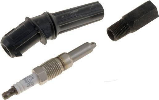

HOLY MO FO!!!! Thats for a 4.6 3V engine NOT OURS. Those are 2 peice plugs from the factory and they break in half when you try to remove them from 3V engines. See the electrode strap on that plug its boxed NOT a 4V plug. You need new FORD mechanic. If he got that in engine piston would have knocked it right out.
I got it towed to another shop. These guys build race engines and he quoted me over the phone for $150. The place that I originally brought it to the guy was going on and on about his 600hp mustang and that he does these all the time blah blah blah. Then I saw that chinsey adapter and thought what kind of crap is he trying to feed me.
