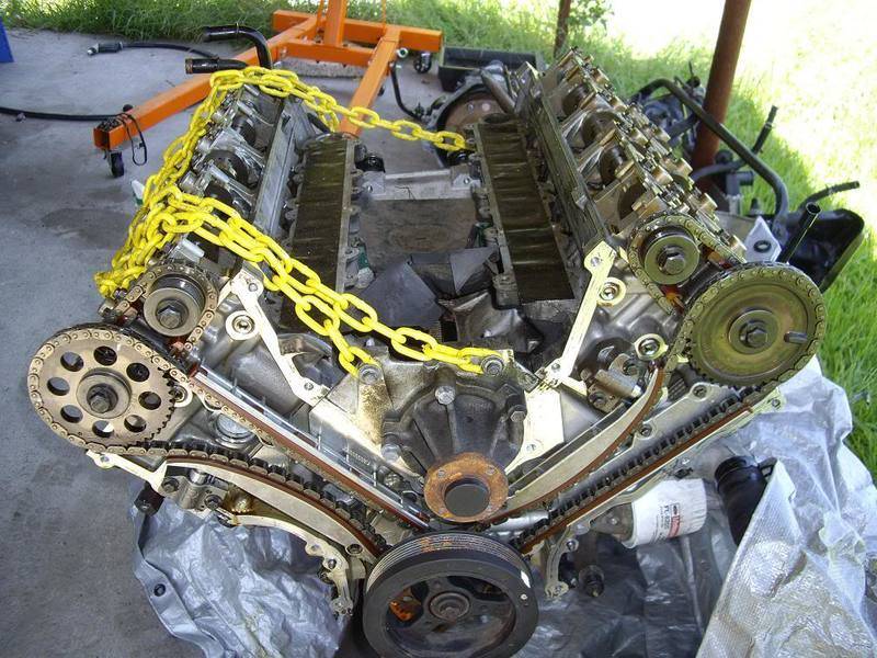

Will my engine work??? Anyone know?
This is the back of a 93
Now the front

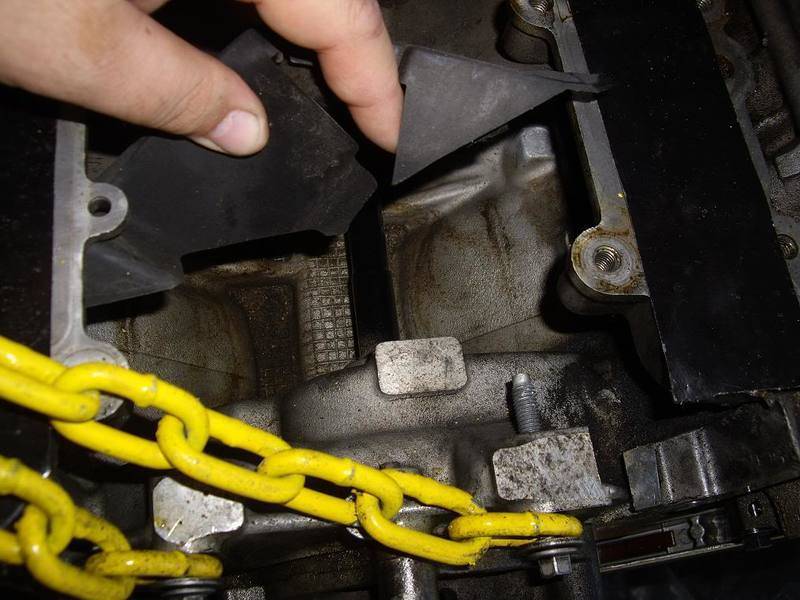

Thanks for the pics. Yes the waterpump goes into a cylinder and this hose that is on mine comes out of the back of that cylinder. I will put up some pics tomorrow!!! Of everything that I have!!!
So I took a pic of mine to see whats what. Yeah, he took the valley pan cover out and there is a hose under there.
So it seems you just have a rebuilt 93 motor. OK, easy enough. Yeah it will all bolt together as long as you have the IMRC boxes. Everything else is the same and the parts that are different such as the plenum and valve covers have been changed over. You are good to go sounds like.
