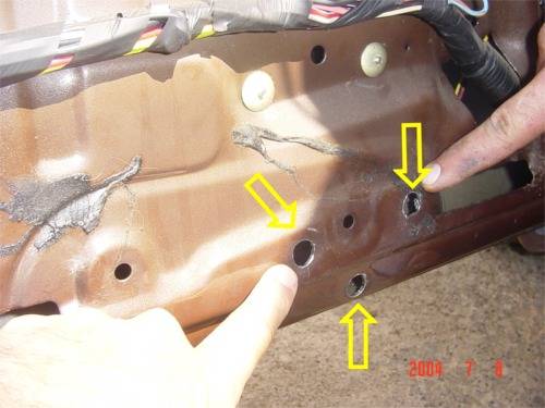

On the door panel you should notice a dimple. The sheet metal dimples are about 3/32" in diameter, and about 1/16" deep. There is one for each of the 3 screws that hold the window motor to the regulator. Not picture for location of dimples. Holes have been drilled already in the provided picture
You will need to drill a 1 / 2” to 5 / 8” hole to allow for an 8 mm socket to loosen and take out the 3 bolts that hold the window motor to the regulator. You may want to start with a small pilot hole to begin your holes and progress to the larger 1 / 2” bit.

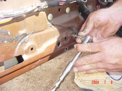

Use the 8 mm socket to remove the three screws attaching the window motor assembly to the regulator assembly.

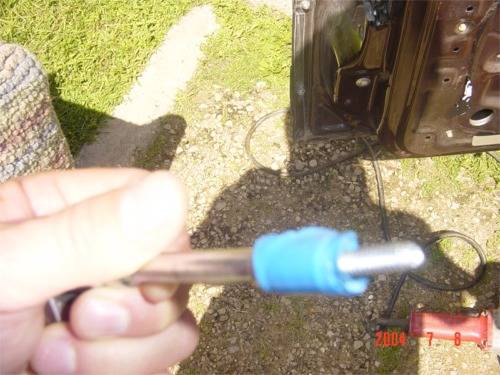

Replace the motor assembly into the door cavity and mount it to the regulator assay. I used electrical tape to help hold the screws to the 8 mm socket when I attached the new window motor.

reinstalling and as suggested , you have to have some way to keep bolt in the socket as you feed it through the door skin ( I use a blob of RTV ) or you will be quite fustrated at constantly having to dig the bolts out of the bottom of the door --
