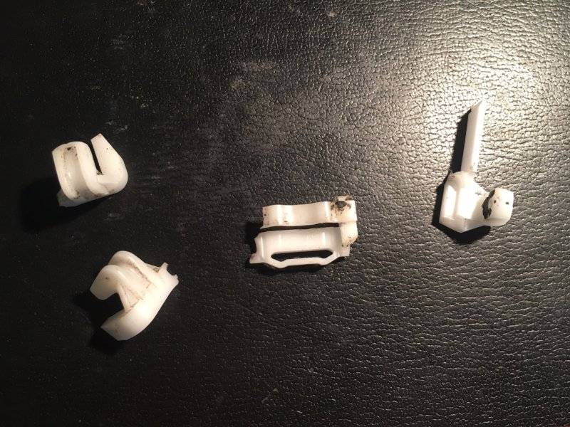

Clips arrived today so I finished the replacement. Manufacturing source is unknown. May be the ones from Turkey, not marked. SeaPro, were your clips from Turkey grey?

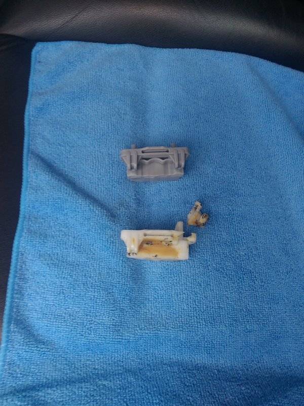

Pic of the clips.
And mandatory stress relief from a local supplier.

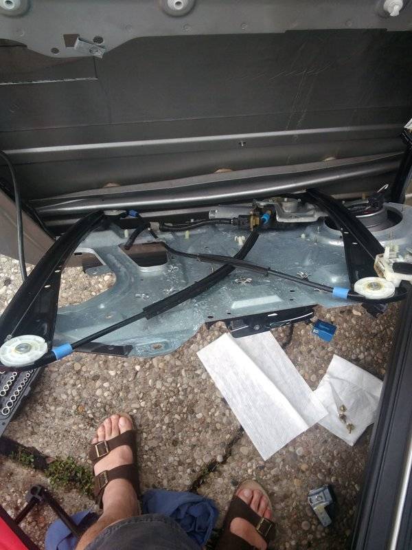

Followed the instructions provided in V-8s post for removing the door panel and loosening the inner metal panel and loosening the window clamps. Need to also disconnect the cable to the door open lever. Works well if the window glass is all the way up. The inner panel can then be leaned out to access the clips.

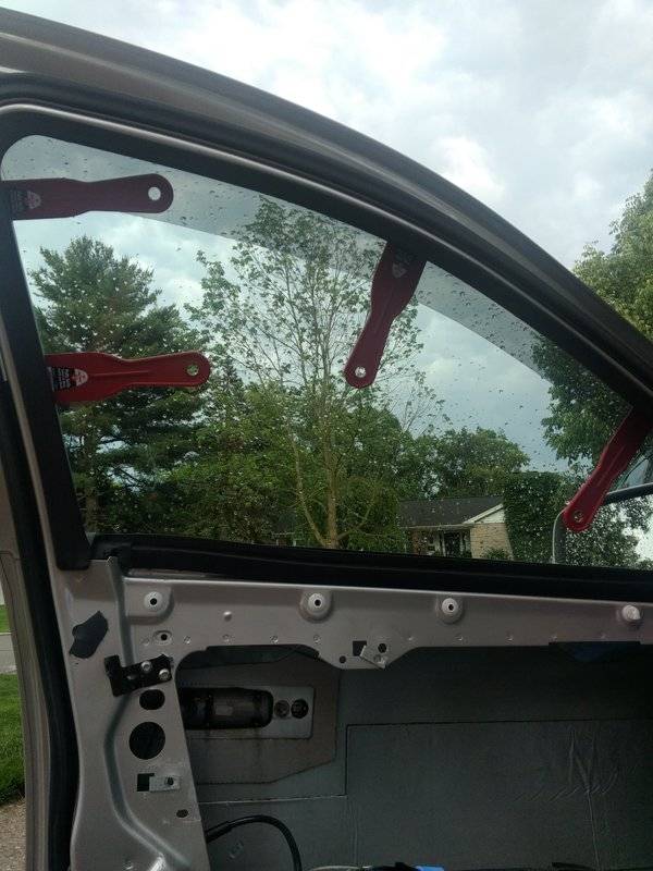

I had already removed the rear clip before I remembered to take the photo. Need to have the window held in place, I picked up a few plastic putty knives that worked well.

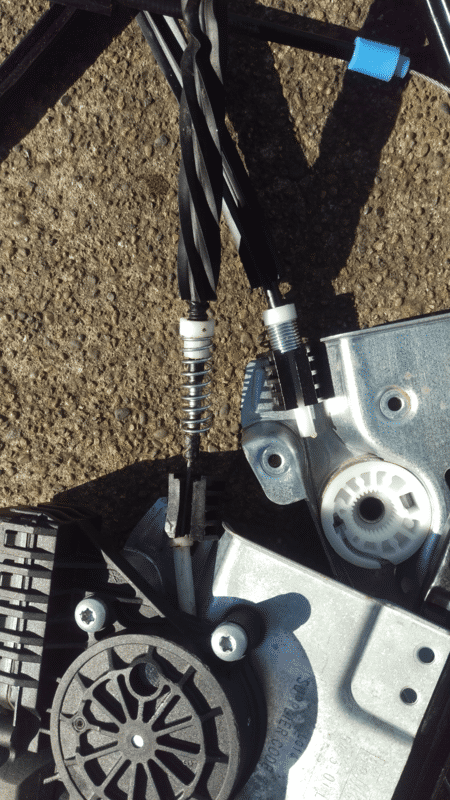

Rear clip is easiest, just pops off and the new one pops on like in the youtube video. I had to drop the window a few inches to get some cable slack to install the new clips. Front clip is a bit tougher. I clamped a needle nose vise grip to the lower cable to keep it on the lower pulley. Once the clip is off the new clip takes a little force to connect. The spring end is inserted first followed by the other end. Once together, it will look like this.
The inner panel can then be reinstalled and the 7 bolts tightened. The window clamps will be down a few inches so the controls need to be reconnected and the window carefully raised. Once the clamps are back in the proper location on the glass, the clamps can be tightened. Reconnecting the controls and testing at this time is recommended. If all has gone well, it moves freely without binding and abnormal noises.
Reassembly is just the reverse of the disassembly.

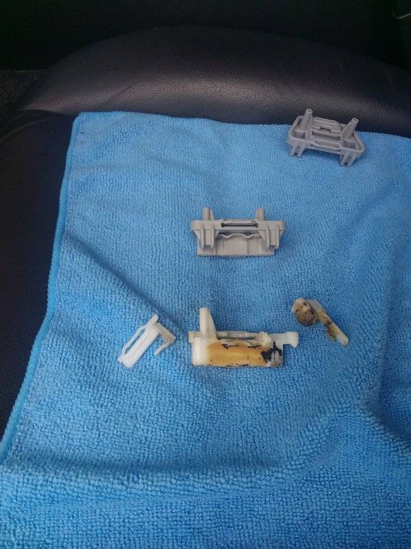

My clips had not completely failed but the rear one was close.
Rear clip.
Front clip.

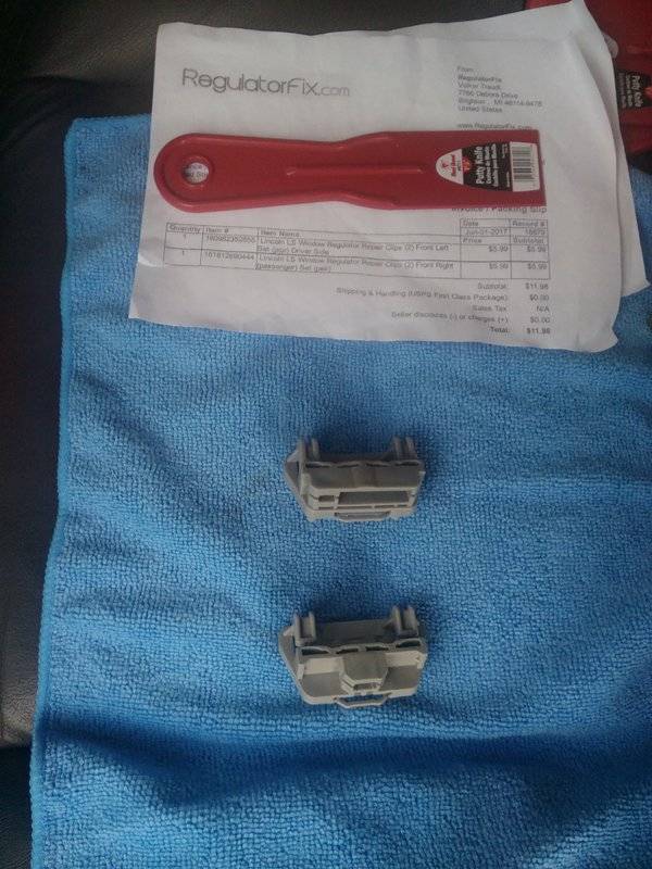

I purchased from regulatorfix. Purchased last Thur evening, shipped from MI on Fri, arrived in KY on Mon. Window operating without creaking for the first time in years.

Those look identical to the ones I bought from Turkey. Glad you were able to get it sorted out. My regulator got all screwed up when I did mine... The cable bound itself up on the drive. NOT a fun job.
If I can get a few years out of them then they will have been worth the $. They are a hard plastic and the OEMs appear to be nylon.
Since the window mechanism was still working, I didn't want the cables to come off the pulleys which is why I loosely clamped the vice grips to the cables near the pulleys. Also didn't want to kink the cables and create a stress point that would lead to a cable failure.

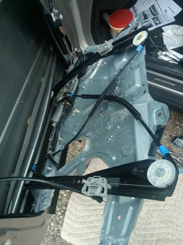

Here's a picture of both the new and old regulators, showing the point of failure.
