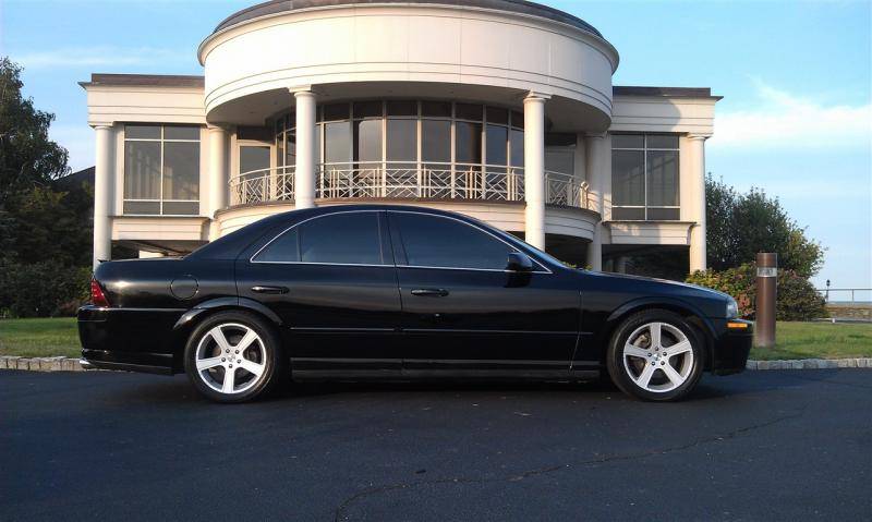

Same wheels just swap the blizzaks on the rears

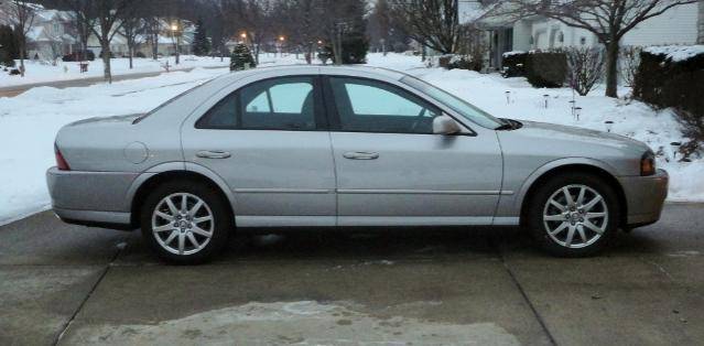

Last winter I picked up a set of Jaguar S-type 17" rims and had a set of narrower "minus zero" sized 215/55-17 Michelin X-ice 3 tires mounted on them. The Jaguar rims are the same size and offset as the LS rims and they fit over the 320mm Jaguar Sport front brakes too. I paid $75 each for them with shipping from a salvage yard in PA. Check on eBay for them - that's where I found these. I even bought a fifth one so that I could have a full size spare.
