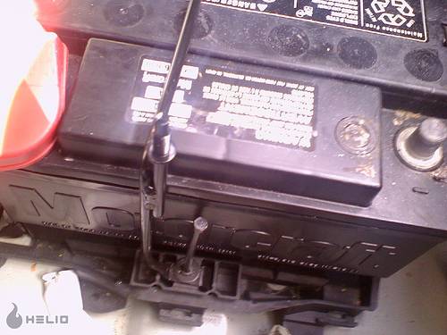

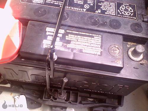

ok, I must be a moron because I can't figure out how to get that rod that goes over the battery off.
I unscrewed the little knob on the left but then what? am I supposed to squeeze those two poles together, or pull thme apart, or what?

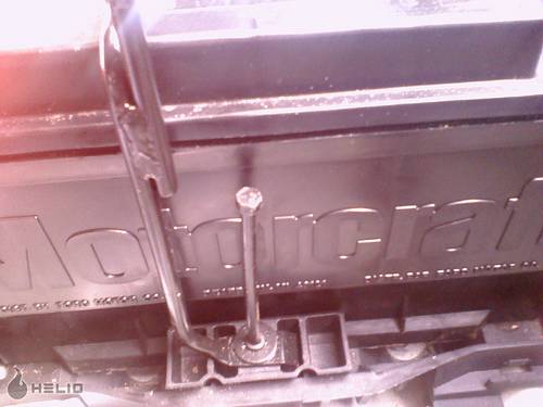

apathy - how'd you get the battery out? I must be missing something really obvious to get that pol off. it runs right over the middle of the batter and screw to tyhe frame on the right, then there are two poles on the left.
I just can't figure out what I'm supposed to do to get it off.
??? I'm completely confused at what I'm supposed to be doing to get this thing off.
you know what, I tried unscrewing that with my screwdriver w/ a hex head on it, but couldn't get enough leverage, I'll try again with a wrench. I wasn't sure if I was doing the right thing and didn't want to break it.
VICTORY. I finally got that :q:q:q:qing rod unscrewed. I was trying to do with w/ a regular wrench cuz I couldn't find my small socket wrench. finally found a completely unopened socket wrench and put some leverage on that bitch.

That hold-down bolt is a piece. I had new battery installed at Ford under factory warranty. After leaving Ford, I inspected the battery while pumping fuel and noticed the bolt was not tight. I could actually pull up on the bolt, causing the battery to slide a bit. Turns out, the bolt had corroded due to the acidic atmospere and possibly some venting of acid onto the bolt, even with the external vent assembly. Also, I observed there is some drains for the spare tire well which allow water to infiltrate the area, causing corrosion.
My point, inspect your battery hold down bolt and spare tire well area for corrosion.
