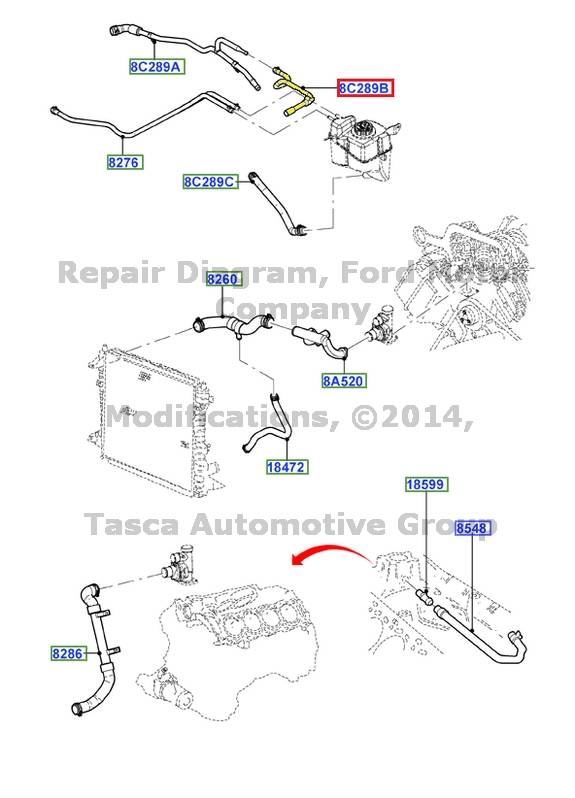

hey Dale, when you get all of the parts for the Degas bottle, can you list all of the part numbers. I will eventually need to replace my bottle as well and last I checked the Motorcraft bottle with the hoses was over $180.
Correct me if I am wrong but the Degas bottle has two hoses attached? The bleed hose (callout 8C289B, XW4Z-8C289-CA) and the return hose (8C289C, XW4Z-8C289-FA)? Ford Parts Giant list both hoses as discontinued?
I just wanted to make sure I order the correct hoses, 2002 LS V8, Automatic, non-sport.
I guess I will need to get a new cap (RS527) for the degas bottle too.
The heater bleed hose sort of mounts to a stud on the degas bottle, but there is no flow between it and the degas, it's just something to hold it in place.
Thanks Joe, I just found a good diagram for the degas bottle area from Tasca using google search.
I attached it, if not allowed delete, it may help others.
