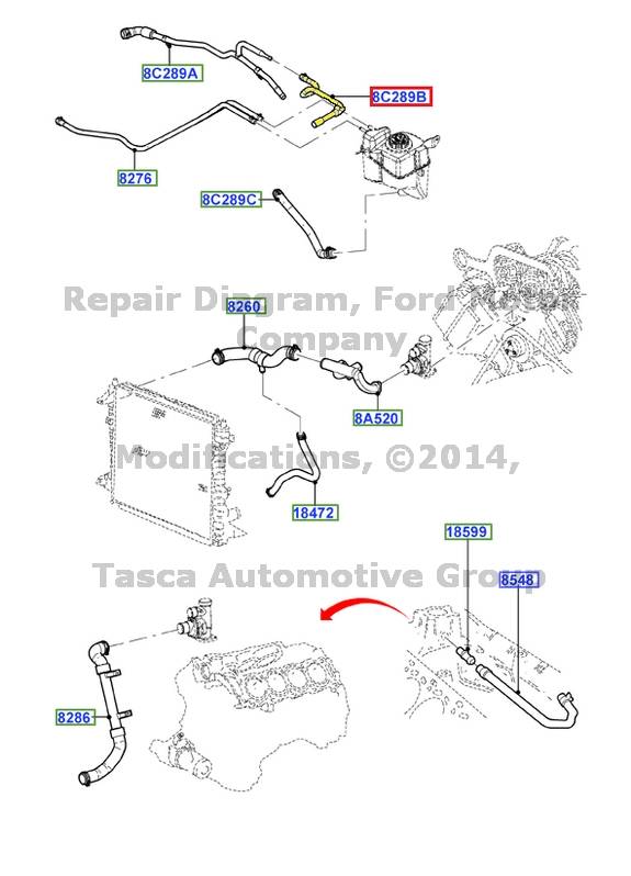

Correct me if I am wrong but the Degas bottle has two hoses attached? The bleed hose (callout 8C289B, XW4Z-8C289-CA) and the return hose (8C289C, XW4Z-8C289-FA)? Ford Parts Giant list both hoses as discontinued?

I might be wrong but pretty sure that did not go to the coolant fan. https://www.amazon.com/Motorcraft-K...ywords=Motorcraft+KM4566+Water+Outlet+Housing
KM-4566 - Genuine Ford Base No. #KM-4566 Hose - Sub Tank

KM-4566 = YW4Z-8C633-AA
NEW OEM HYDRAULIC FAN SYSTEM SUB TANK HOSE 2000-02 LINCOLN LS 02-05 THUNDERBIRD | eBay
Then I find this: Engine Coolant Recovery Tank Hose MOTORCRAFT KM-4566 | eBay
Same hose? Different application? Or Ebay Tasca wrong somehow?
Just trying to figure this out, getting somewhat confusing.

Was researching these two hoses today (Motorcraft KM4566 Water Outlet Housing
and Coolant Recovery/Engine Coolant Recovery Tank Hose XW4Z-8C289-FA) when I saw this thread, do not mean to hijack your thread Dale.

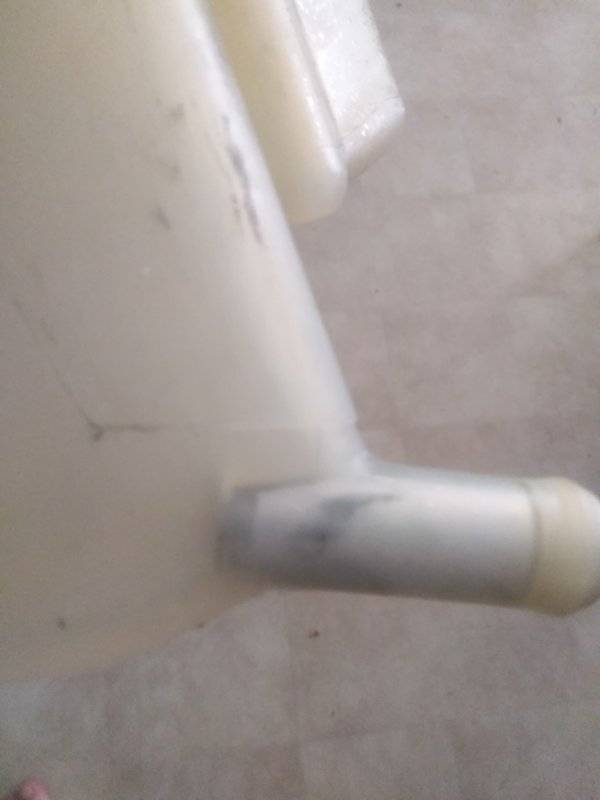

The Motorcraft degas bottle (5W4Z-8A080-AA) comes with the coolant return hose 8C289C (attaches to bottom of the bottle via the tube pictured in Dale's screenshot, post #53) AND the heater air bleed hose 8C289B (that only attaches to the degas bottle). The long hose 8276 (the actual degas / engine vent hose) that runs from the thermostat assembly to the top of the degas bottle does not come with it. XW4Z-8276-CB ?. I don't think people change it.

I don't know what KM-4566 / YW4Z-8C633-AA is about or where it goes; I had the same question. It is NOT the coolant return hose (8C289C / XW4Z-8C289-FA). After doing my shopping list/inventory, I don't see where it would even fit in. I have a feeling that it might be Gen1 specific part, but not sure. Notice from the pictures that it has a bracket to attach it to something at one end. Also Tasca describes it as: "Sub tank. P/s cooler to resv. 3.0L, 2000-02, cooler to reservoir. 3.9L, 2000-02, cooler to reservoir." Power steering? Anyway, I no longer trust any of these part store descriptions.

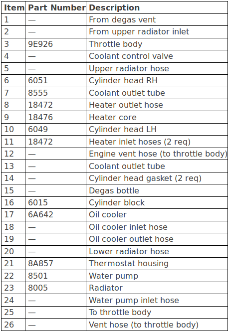

Your diagram from post #50, for the short p/n on Gen1 (notice some inconsistencies, so maybe look for a better version if you can):

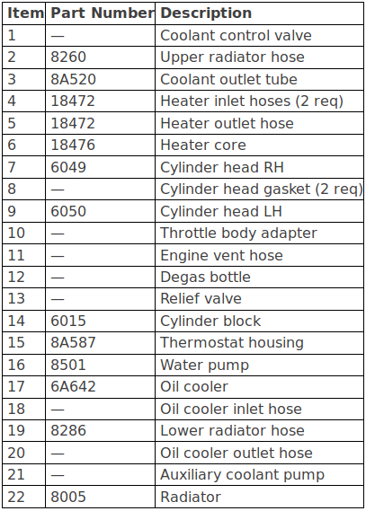

Here are better Gen1 diagrams. No part numbers though.
(There might still be some discrepancies, but at least the engine vent hose does not bifurcate just before the degas bottle and the upper and lower rad hoses don't both connect to the same port in the thermostat housing tower...)
Gen 1 - V8, 3.9L (Coolant flow diagram)
Gen 1 - V6, 3.0L (Coolant flow diagram)
