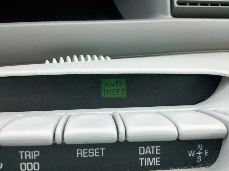

I brought the thread back to life and see if any of these will be the solution. no anti theft light here either on my 98 lsc
98 does...... open the door sit inside and press the lock button this light should come on solid and then flash when the door is closed

hopefully that isnt my problem. I checked my fuses and relays and they are all fine. I think my clockspring is shot because my horn doesn't work but i swapped the relays to try it anyway. The anti theft light is only on when the door is open with it closed and door locked the light is off. any other ideas?
