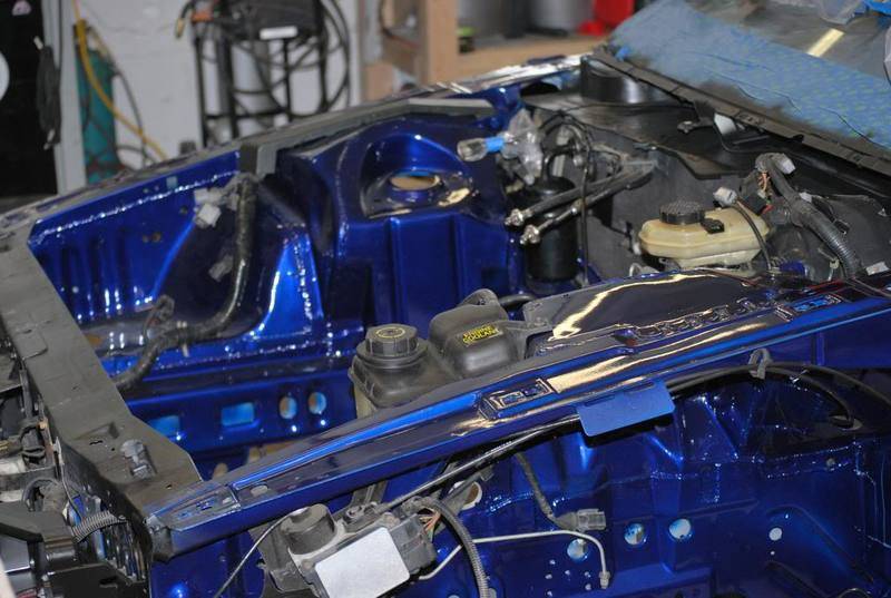

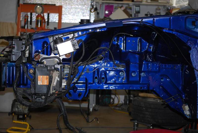

I'm taking a break from the shop this weekend, but hope to start putting the engine compartment back together this week.
Moar progress!

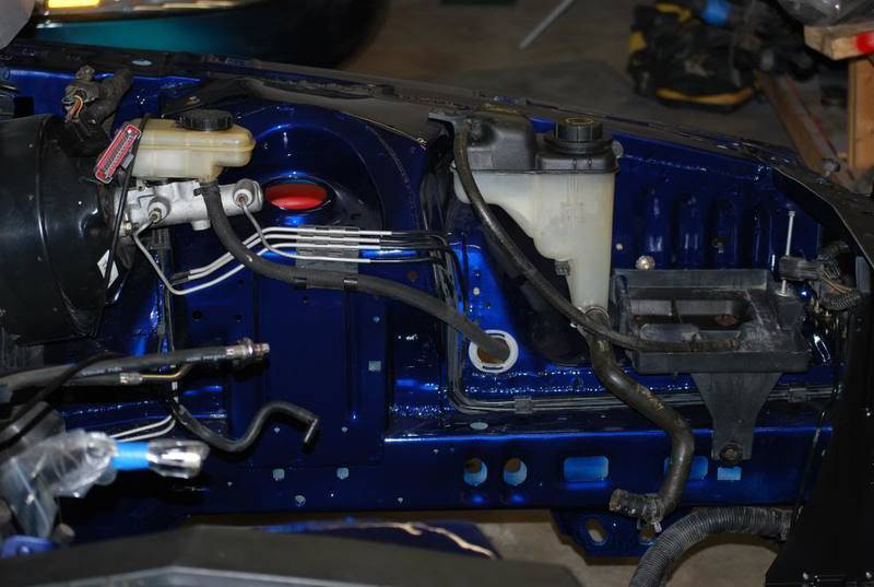

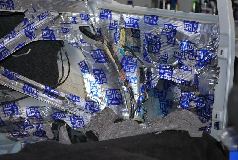

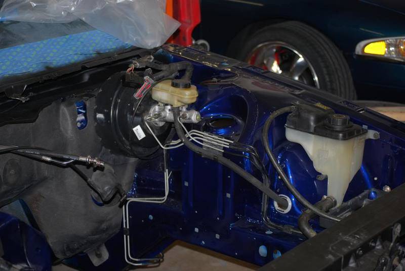

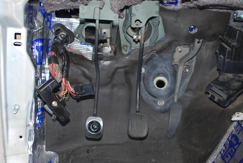

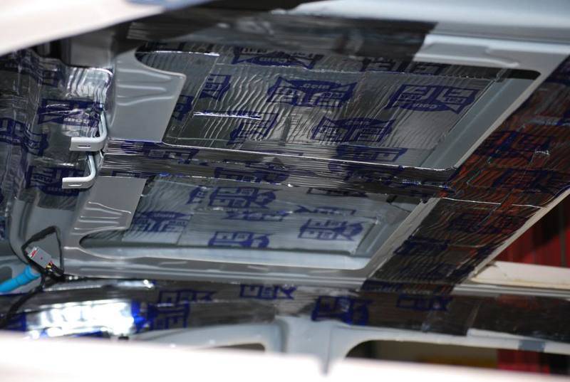

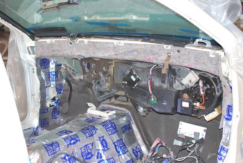

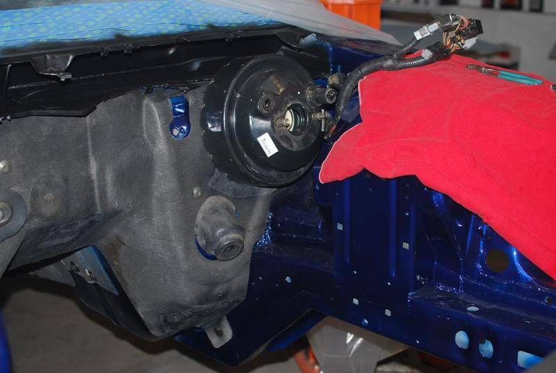

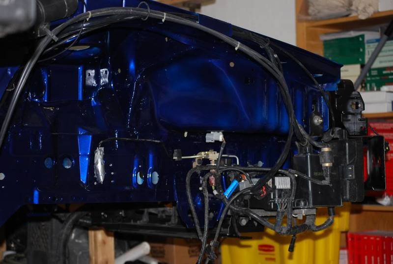

Started laying the deadening material on the interior. The firewall got 2 layers of the stuff. After that, putting the firewall back together began
Pics
Nice work Mike, I would also do two layers on the rear floor, forward facing riser and under the rear seat.
Got the Brake/Clutch pedal alignment figured out, and bolted down.

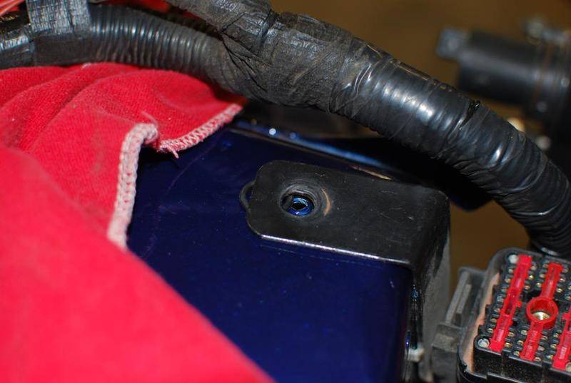

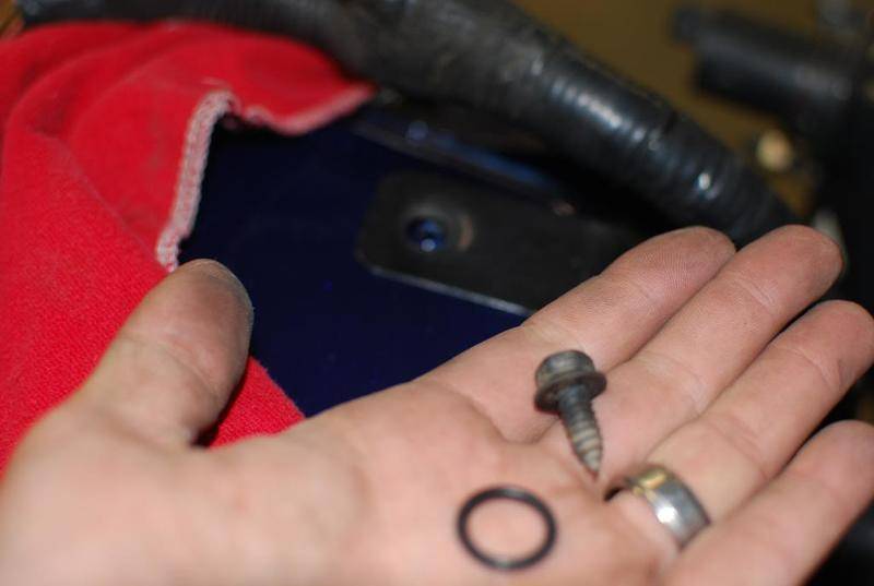

I'll be putting these O-rings under any area that a bracket touches the paint as well.

Engine, subframe braces/shock tower braces/OBDII.
Got a budget to stay on, and I'd like to drive it this year.

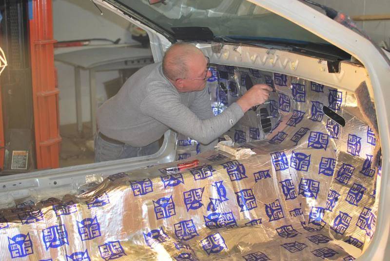

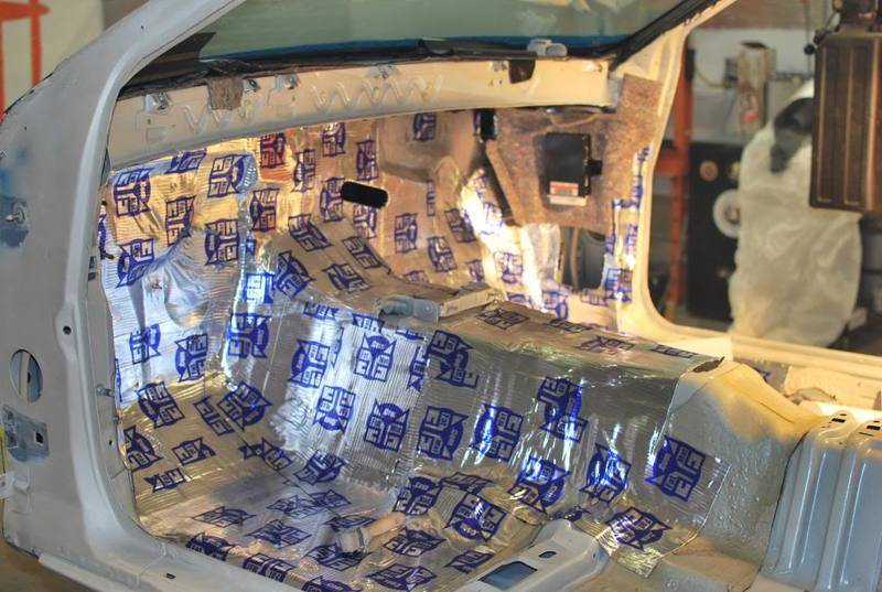

Approximately how many sq feet do you think you're going to use of flatmat?
So what's your reason for converting it over to OBDII? Easier tunability?
I bought 100 square feet and that wont get it completely done.
150-200 is looking more accurate.

And yes.
OBD tunability.

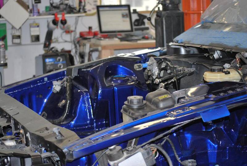

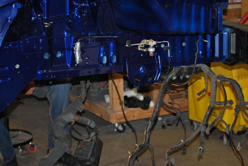

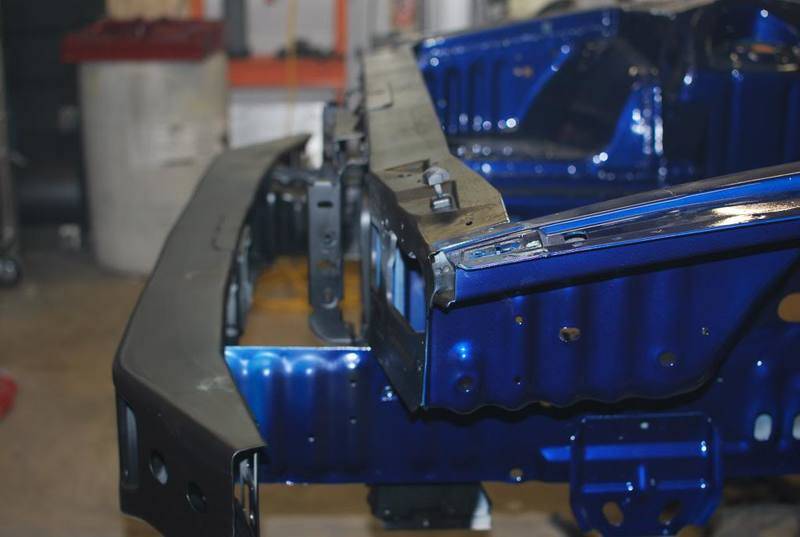

Got quite a bit done since the last update.

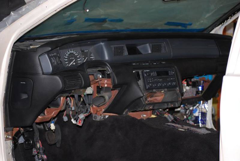

Dash is installed, used the last of the 100 Sqft of sound deadening (ordering 100 more feet this friday), Firewall, and inner fenderwells are coming back together as well. Sending the Cam Covers, and Front timing cover off for coating soon as well.
Hey Mike, where are you getting the Fat Mat from? I've been looking at getting some for the trunk of my G8, and for the 98 Mark. It seems to be a pretty decent price on eBay, but just wondered if you had a better source.
