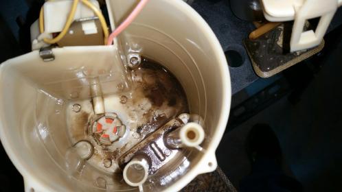

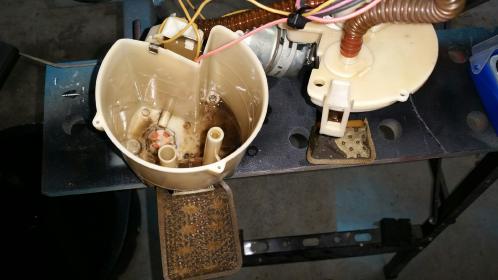

Thanks, that's reassuring, I was worried it might be something more complex (electrical). I have a new pump on the way and I will replace that plus the filter this weekend and see if that improves starting. I don't have access to fuel pressure gauge but will have the pressure checked if replacing the pump and filter don't improve anything. I did replace the jet pump 6 or 7 years ago during a cold winter in the parking lot of my apartment as well as the fuel pump a few years ago.... It seems that most of my issues with this car have come in the winter - at least I have a garage now.
I replaced the fuel pump and pump filters tonight and it runs and starts so much better. I think the dirty/clogged filters on the pump and canister caused issues pulling in fuel in the cold. I don't think it will get really cold any time soon to test it out but at least it runs better. I still need to replace the fuel filter in the wheel well. There was a slight hesitation at high rpms when stomping on the gas that I contributed to possible coil failure but that hesitation is gone now.
Replace that filter quick, because a clogged filter will screw up a new fuel pump in an incredibly short amount of time. It might even be what caused your current pump to go bad. Fuel filters are generally only good for 1000 gallons and ideally you want to replace it every 500 to 750 gallons. I recommend Wix fuel filters.
