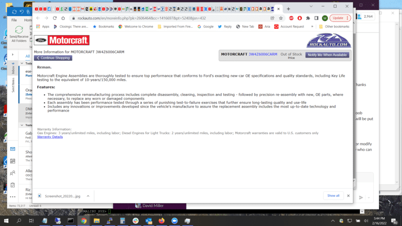

Rock Auto engine parts for a 2003 V8 3.9l

There is the part number for a long block at rock auto.
