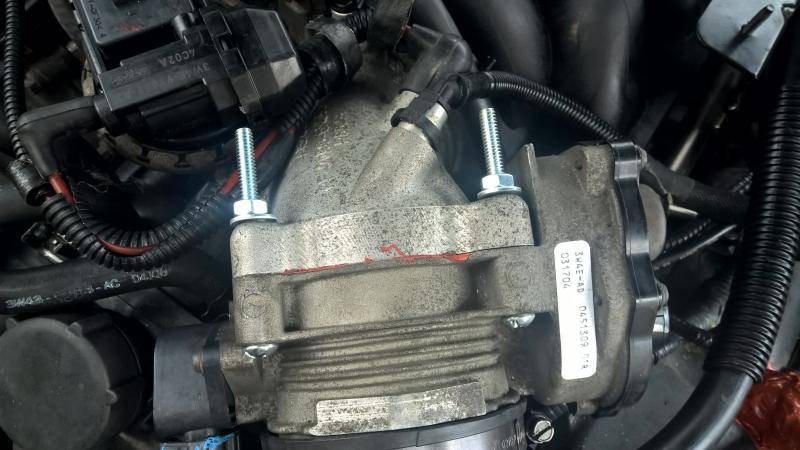

Well besides needing to replace the valve cover because of my obvious pcv leak, I think my overheating issue is gone. I replaced all the cooling system part minus the hoses. They looked to be in good shape. During my journey I found that the intake manifold was missing a bolt and that the hole was semi stripped. I ran a tap down the threads to clean them up and then went to lowes and picked up the proper threaded bolt and cut it to the right size and threaded the shank to the right length. It tightened up pretty good, but I'll keep my eye on it. I also found stripped threads where the piece between the tb and the manifold connect into the manifold. Again I chased the threads and the bolt tightened up fine during re assembly. The real kicker came when trying to bolt the TB back on that piece before the intake manifold. The top two holes had ****tly done heli coils that were falling out and that bolts wouldnt tighten up..... At this point it was about 11pm, but I realized it was either try something and ruin the part and then got to the junk yard in the morning or just go to the junk yard. I decided to experiment with some items purchased at my friendly neighborhood walmart. I bought a 1/4 nch drill bit 2 wall anchors (happen to be very long 1/4 inch bolts) and some 1/4 inch nuts. Came back home and drilled through the threads out the other side and then added a bolt and tightened it down. I know its pretty redneck, but didnt have to many options. Bleeding went well. It now works like the instructions say it should. I drove the car all over stopping and going and the temp stayed between 206 and 220. This was with the a/c on and off and the heater on and off. Ill try it in some real traffic tomorrow, but I think the LS is good to go.

Here is the repair!
